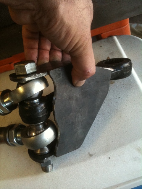

Single swinger steering update
Since I trolled this board hard and asked quite a few questions, here is how it turned out.
About $500 in steel and rod end bearings.
1.25 .120 dom tubing for the tie rods
3 - 3/4 rod end bearings with 5/8s mis align
3 - 5/8 rod end bearings
Grade 8 bolts fine thread and metal top locks
One stock salvaged pitman
misalaineous plate steel
150 hard pre-run mile in baja so far without issue....

Are the relay and tie rod off the pitman in single shear? Is that bolt shanked out all the way?

I believe it qualifies as double sheer...
