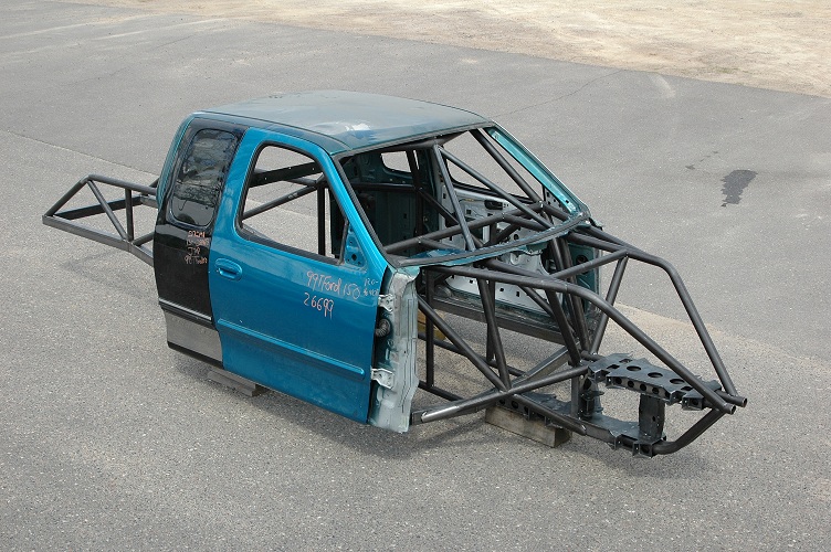

I'll play, heres some stuff I've built. I'll get more bronco specific ones when I get home from vacation.
- DSC00734.JPG (194.92 KiB) Viewed 3057 times
- DSC_0193.JPG (220.83 KiB) Viewed 3057 times
- DSC00798.JPG (280.26 KiB) Viewed 3057 times
- side w seats.jpg (76.27 KiB) Viewed 3057 times

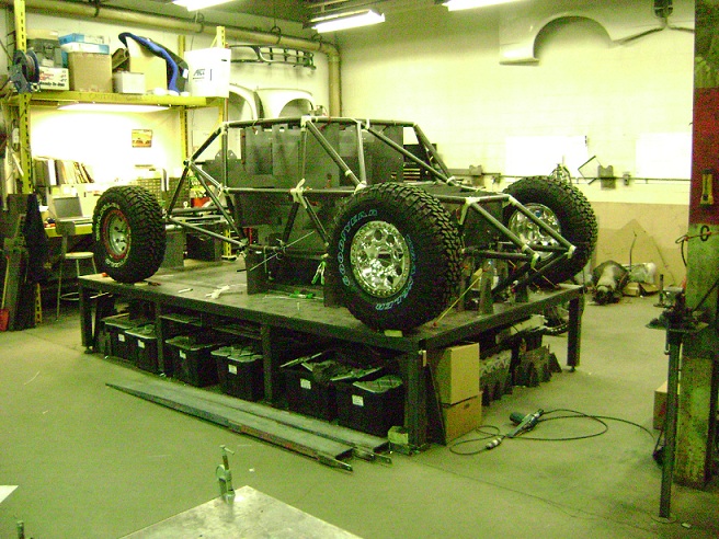

Steve, no takers or even tire kickers on that Ranger? Would make for some decent coin to help you finish the crew cab.
Re: How about a cage thread.......
I haven't been pushing the sale or advertising it at all Chris. It's buried in my shop so I wasn't going to even list it until the crew was rolling since the crew is one of the major things blocking getting it out. BUT a guy who has watched the build and always liked it has expressed interest & given an offer. If we can work something out it will have a new home somewhat soon.
If it does the $$ gets put aside for superbad - not the crew. I'm weird in that I have set budgets & $$ set aside for each build & I don't mix them if I can avoid it.

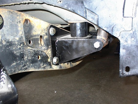

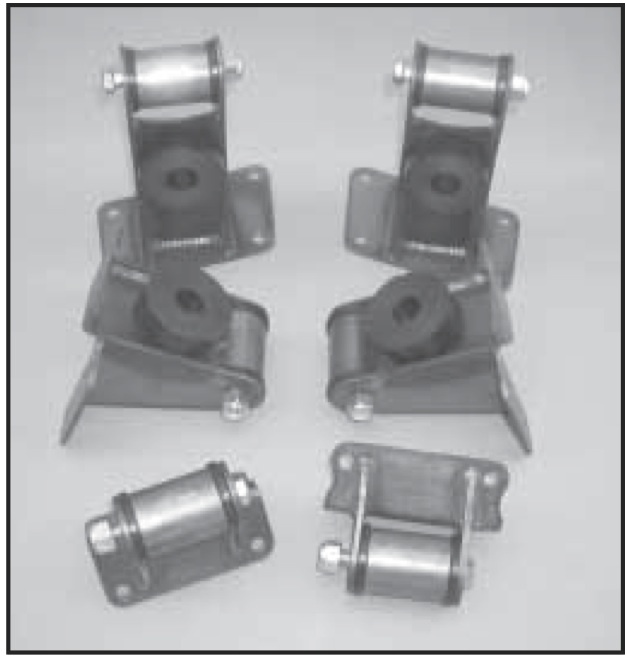

Here's the full set right out of Autofab's catalog - it includes the front cage/body mount bracket, the middle cage/body mount bracket, and then a pair of more conventional bushings/brackets that's used for mounting rear legs of cages to the frame terminating under the middle of the bed lengthwise:
Here's a regular picture of one of the cage/body mount brackets, but I think this is from a Ranger. Maybe slightly different?
You can also do one of these bushings/tabs for the main hoop on the front leaf spring hanger, but John told me it's really intended for part of the rear through the bed shock towers.
Re: 'Through the Dash' cage design question / help please
D'oh - I forgot I have one of the new catalogs sitting here that I could have flipped through to look. But thanks for posting pics. I like those!
