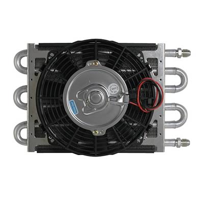

Although I've always viewed Derale and Perma-Cool as the lower end of cooling products, I'm looking at using this one for the steering cooler due to the economics of it. Any what are your thoughts?
Re: Power Steering Pump Upgrades/Coolers
Those are 5/8" tubes and 6an fittings.

yikes wrote:Although I've always viewed Derale and Perma-Cool as the lower end of cooling products, I'm looking at using this one for the steering cooler due to the economics of it. Any what are your thoughts?
Agree Permacool or Derale are low end. Thin tubes are fragile. Finns are even more fragile . They are like Al foil.
That picture of a blower cooler is way overkill for PS
I use a 2 pass with push-on hose fittings. And my pump is working hard. Remember the cooler goes into the return line and the pressure is very low at that point. Look at the PS coolers from Summit. 2 pass , cannot remember the length. If your packaging is bad and the cooler sees no ambient air flow its possible that a blower could be needed. Just mount the thing in front and all will be good with no blower.
