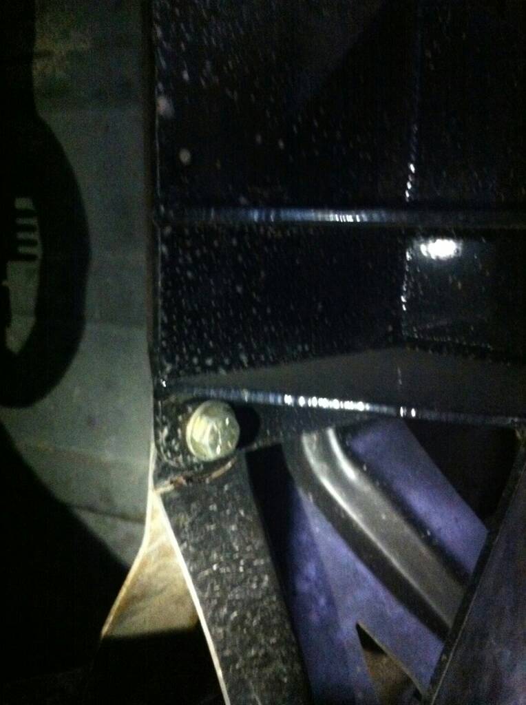

emailed you pics of the rear set up Brian, working on finding shots of the crack on the crossmember
Re: Rear Traction Bar setups
Here is what you had sent me Bray...
[attachment=-1]uploadfromtaptalk1398744848199.jpg[/attachment][attachment=-1]uploadfromtaptalk1398744863537.jpg[/attachment][attachment=-1]uploadfromtaptalk1398744874976.jpg[/attachment]

All things considered that is a just a 1/8" stamped steel x-member. Even a perfect link is gonna have a good mount of push/pull being thats its job. I dont know if I would take the time/$$ to plate the factor x-member rather than just replace it entirely.

cs_drums wrote:All things considered that is a just a 1/8" stamped steel x-member. Even a perfect link is gonna have a good mount of push/pull being thats its job. I dont know if I would take the time/$$ to plate the factor x-member rather than just replace it entirely.
Gotta agree with Autofab on this one, you are making the x-member do something it wasn't designed for. That is just a stamped steel x-member and we crack them on a regular basis. It might look like it is just around for the ride but it is there to keep the frame rails from twisting as the springs put a cantilevered load on the hangers. We do plate the area around the bolt holes on the x-member because the hole creates a stress riser there.
This about sums it up. I had a similar one on a 4 runner rip a chunk out of the cross member. I know it cycled perfectly, it's just that the cross member was not up to getting hammered on like that. Replaced cross member and off it went.
I do prefer a big squishy bushing on the frame end of the bar though. I believe this takes a lot of vibration induced stress out of the mounts. It will also transmit far less noise.
