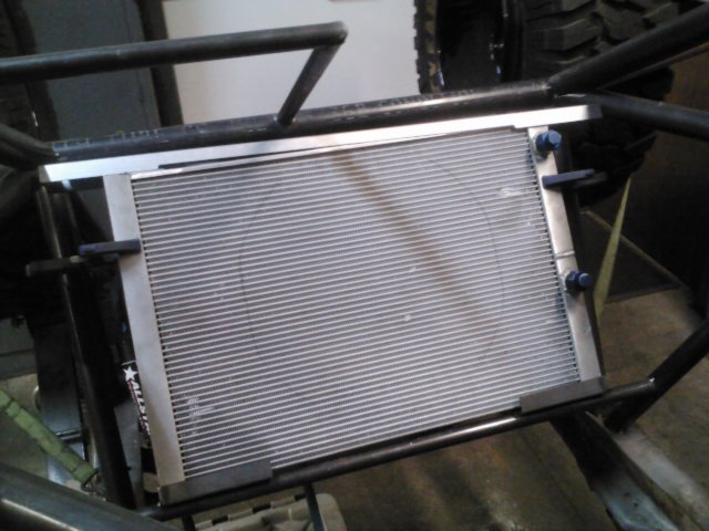

What are ya'll running for trans coolers?
Post by Joxracing »
Just like the title says... Looking to get an idea of what trans cooler to run for the #505 F150 Stock Truck of ours. It'll be mounted in the "bed" (just bedsides) along with an electric fan.
Size, would like to have as big as possible. Is there an extremely large OEM one out there thats a pretty go-to cooler? Or any suggested after market ones? Again, price is "low budget"
Thanks!
Re: What are ya'll running for trans coolers?
Keep an eye on e-bay. I've got a large aluminum cooler, don't remember the brand, I bought it a while ago. I got it from a road race guy for like 100 bucks. I believe he was running it as an oil cooler (it has AN12's on it), I changed the fittings on it and plumbed it for trans.
trans cooler.jpg (109.33 KiB) Viewed 25150 times
