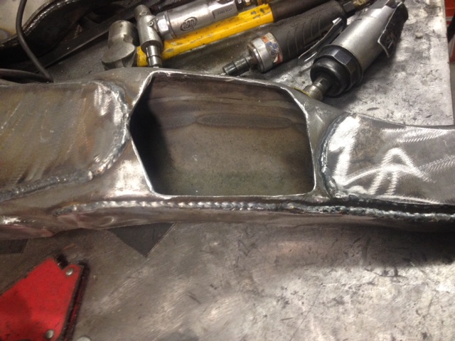

Is the window porting on the passenger side beam neccessary if you are running coil springs? I am running 2.5" 12" travel shocks if thats a factor. Just guessing the travel numbers in a coil spring front end isn't quite that of a coilover setup.
Re: Start Your Go-Fast Build-Front Suspension
You'd be shocked. 16" of travel is definitely there with a coil. Port the window.
Posts: 2338
Here is my port job..........I have added quite alot of plating so hopefully everything is still really good an strong.

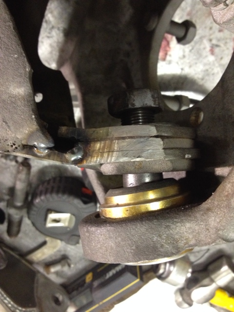

Lower Balljoint Location Tip
I am very new to the FSB and just finished my first C&T front end. One thing that killed a solid afternoon (mainly because the first time I have done this) was getting the front end perfect-- then getting it back on the bench and finding out your ball joint was not properly aligned. So you either say screw it or tear it all back apart-- I tore it all back apart. What I cam up with (which is probably old hat for your veteran C&T'ers) is to just simply get the cut out portion aligned perfectly and then tack that cut out to the knuckle to hold it in place. Being that its in place you can get the alignment and caster right off the bat. Just kind of a complete A-Ha!! moment in the C&T construction :-)

Lower Ball joint Trick
tacked lower Ball joint ear........

When we did my lower c/t we used zero degree bushings and the knuckle to align it. I was fortunate to learn from a pro. Before I extend my housings, I am going to build a jig so if I bend or break mine I can replace them with alot less effort.
