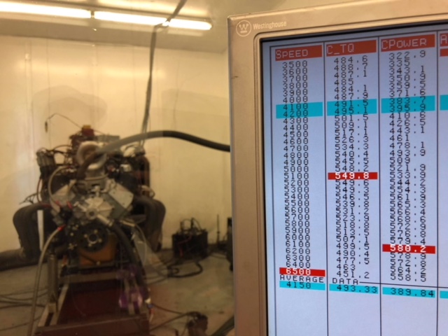

Fresh stroker for the Bronco just completed. This was built to my spec's. Just got final dyno and tune done. Will try to have it together for Vegas to Reno

Re: Stroker motor talk!-Threads merged
Here’s the tcinu2 numbers that matter- and these numbers matter!!
