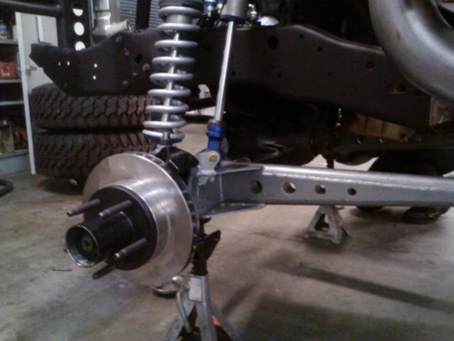

Bringing back an old thread.... Does anyone have the part numbers for the studs they used to upgrade from 1/2" to 5/8" ? Looking at the front hubs the knurl is pressed into the outer hub so the knurl has to be 1 " long. Does anyone have the front and rear studs they used ?

If you pound one out backward napa will match it up. Do same knurl length.

I already have them out, I was trying to find them from ARP or online. But I'll have to check with them. Thanks

Re: 5/8s Wheel Studs
Thanks for the information. The Leland units work for the fronts but not on the rear ( for my taste), as the knurling does not extend to the head thus leaving a gap in the knurling which I don't like on the rear. However I did find that Moroso part number 46240 does work for both as the knurling extends far enough up the head to catch the front hub and be fully seated on the rear flange. And not near as costly as the ARP studs. Now for the lug nuts......
