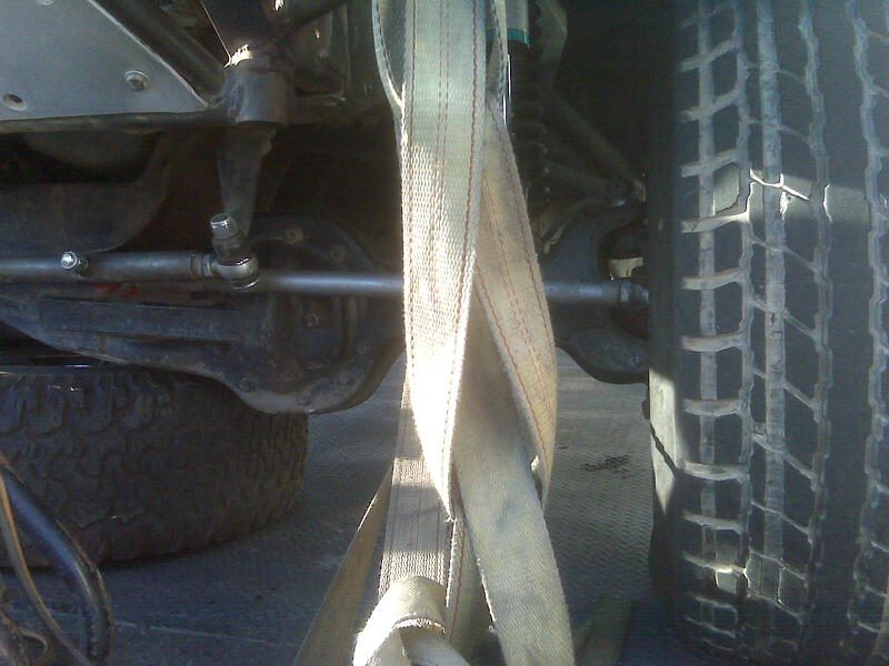

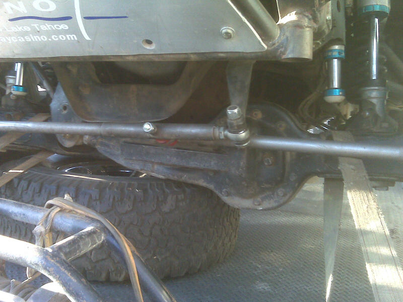

Out testing shocks friday I bent the ambulance drag link...with that said I would recommend building one from scratch or sleeving the stock one with chromoly. I will replace with another ambulnace one for now but something better will be in the works.

Where and how did it bend? Do you have pictures? My crew cab with 37s has never bent one of those even when I tacoed a radius arm and cracked the frame!shockseals.com wrote:Out testing shocks friday I bent the ambulance drag link...with that said I would recommend building one from scratch or sleeving the stock one with chromoly. I will replace with another ambulnace one for now but something better will be in the works.

It bent at the bend. If you layed it on a flat surface as new it probably had an inch rise at the highest part...now it probably has a 3 inch rise.
It bent doing some shock testing in whoops. They went out of sync so it dropped the nose in a hole and bottomed then popped the front up and wheeleid for a ways. Didnt bottom all that hard, didnt land hard and I never even slowed down thinking it was nothing. Throughout the day prior I hammered it way harder through some shit that was just way too big for the truck and nothing bent or was hurt.

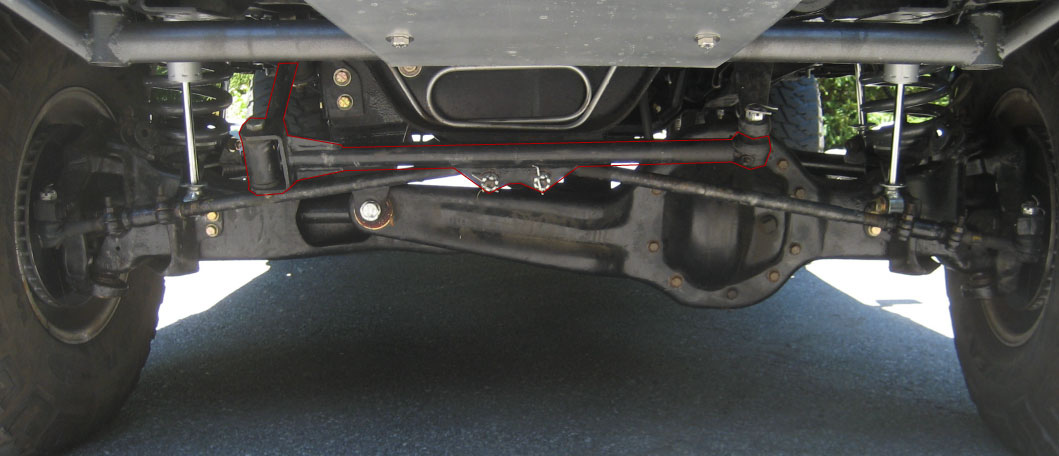

Hiya guys- I've ironed out the major bump-steer problem I was having with my Superunner steering (I had a very loose drop bracket, doh!), but I'm still left with big toe changes as the suspension cycles up and down. I haven't had the opportunity to swap in the stock steering as you guys recommended, and as I'm a stubborn SOB, I want to see if I can make what I've got work really well first.
So here's my idea, which looks pretty simple and nearly free - please let me know if you think it will work, what kind of changes or tweaks would be necessary, or if I'm just a dumb-ass to think about doing this:
The Superunner system looks to me to nearly the same concept as the Single Swing systems I've seen elsewhere, except it has short steering links that meet at nearly the same point, and not long/equal length rods that cross-over. So why not just move the link locations so they cross-over and put in equal length rods? It would be easy to do so - just:
1. Cut out the brackets and re-weld them in the new locations;
2. Reverse the passenger's side bracket, and then offset both brackets slightly fore and aft (longitudinally in relation to the car) to avoid one rod hitting the other's castle nut or rod end; and
3. Extend the existing rods by cutting, splicing in extensions and then sleeving & welding them.
Here's a pic of the existing configuration:
Here's a pic of the configuration as modified:
Thanks, Sy

The points would need to be moved further out.
Just from looking at it and what I know of TTB's is that the block in the center needs to be dropped down about 1.5-2" in your case. For best results when using bracket lift kits is that the links should be about as flat as you can get them. In the case of cut and turn beams this doesn't apply as much.
If your going to modify the link I would first start with dropping the center block.
Looking at the TTB geometry a single swing setup will not work well with the drop bracket kits becasue the length of the arm would have to be stupid long to get the correct geometry that minimises bump steer. Cut and turn beams work well with the single swing setup and stock pivot brackets.
On my Bronco II I dropped my center block down 2" and it now puts my links nearly flat and this has proven to give the best street manners. I have tried a stock linkage with the drop arm and it wasn't plesent to drive.

Pivot points for steering are best located by keeping them in line with the beam and radius arm pivot. I will try and draw a picture later.

While the geometry in the second pic would be way better than what you currently have, Actually getting everything to clear when you cycle it is almost imposable.

Kritter never took pics of his bent steering so I bent mine.

Mine didnt bind. I noticed when I straightened and sleeved the ambulance drag link the material was fairly soft and easy to work with. Now bondo bob has the upgraded version that is chromoly sleeved and tig welded. Should be good to go now.
I have 1 more ambulance drag link without the adjuster or TRE that I will straighten and sleeve with chromo for $100 if anybody is interested.
I did send pics to steve, if he saved them he can post them. Mine bend on full compression both times and my bump is limited with a 1" spacer under the bump stop.
