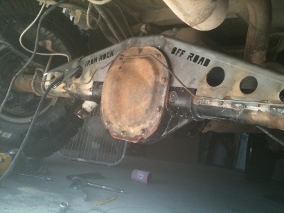

I understand the need for ground clearance etc, but putting a 'upper brace' on a 8.8 is like putting an ashtray on a motorbike, its pointless. Unless you want to attach links to the top of the 8.8 casing, a tension brace underneath the housing is what the 8.8 really needs. The cast iron centre section and the axle sockets are really weak compared to a 9". An upper brace only gives leverage to stress trying to pull out the tubes from the centre housing. I have converted several tradesman's F trucks to 9" because the 8.8 housings smile and leak real easy with overloading (common here). I WAS going to sleeve mine and fit 9" ends, but the cost outweighs the 9" replacement several times over. Besides, we have quite an industry focused around the Ford 9" and virtually nothing for the 8.8. My opinion doesnt mean much, but just saying.mesquito_creek wrote:I did a complete rebuild and extendo 8.8 with a upper brace for about ~1200.

I am hoping the way that upper brace that the jeep guys have developed pretty much stops the tubes from spinning and thats about it. I am not suggesting it stacks up to the way many different 9 inch housings have been built to hold up to the abuse. I do have alot of miles running alot of 8.8 getto fabulous rear ends, but I am not selling it as equal. But properly done on a "pre-runner" as the OP qualified his truck as, he can try it knowing others are running it and providing an opinion on it, who will report success or failure. My original stock rear end housing never failed with over a couple 1000 miles of baja prerunning. I sheared off all the studs on one wheel and destroy other wheels, broke U-joints and the what not. I dont jump my truck on purpose either. I run this truck purpose built for Baja and there is one thing I know that there is ample supply of and that is ford 8.8 rear ends in salvage yards up and down the penisula... So for me retaining a bolt in solution is part of the give and take of the equation.

Amen Brother!mesquito_creek wrote:I am hoping the way that upper brace that the jeep guys have developed pretty much stops the tubes from spinning and thats about it. I am not suggesting it stacks up to the way many different 9 inch housings have been built to hold up to the abuse. I do have alot of miles running alot of 8.8 getto fabulous rear ends, but I am not selling it as equal. But properly done on a "pre-runner" as the OP qualified his truck as, he can try it knowing others are running it and providing an opinion on it, who will report success or failure. My original stock rear end housing never failed with over a couple 1000 miles of baja prerunning. I sheared off all the studs on one wheel and destroy other wheels, broke U-joints and the what not. I dont jump my truck on purpose either. I run this truck purpose built for Baja and there is one thing I know that there is ample supply of and that is ford 8.8 rear ends in salvage yards up and down the penisula... So for me retaining a bolt in solution is part of the give and take of the equation.

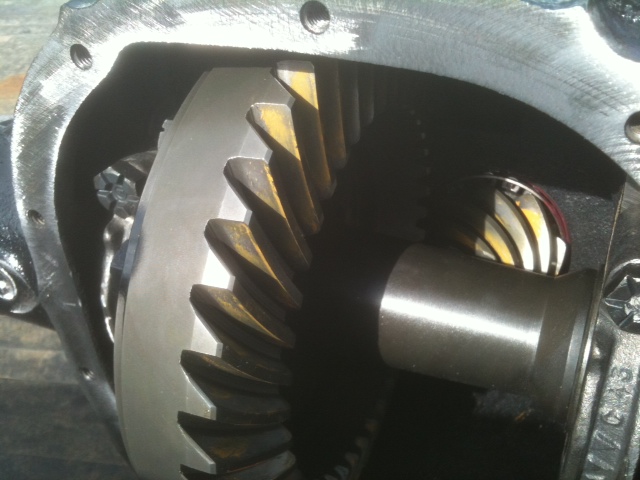

I don't want to turn it into a free ad for the brace manufacturer, but I thought it was a pretty good piece for 99 bucks and saved me a ton of time trying to out think it. You have to retain the offset becuase its built into the aftermarket brace. I am not sure if the leaf spacing is the same on a Bronco vs f150, but my guess is that it is the same where the 40 inch brace will work... And here is a pic of an 8.8 on a spool with 4:88's for what its worth, (C Clip Eliminated) with the 9 inch axles/ends/retainers...

We used to think the same thing, but found that if you hit a rock or big center berm with the center of the axle, it puts the top of the housing in tension and you can break it that way. Of course if the rock was big enough, the housing shatters anyway. And many of those top braces look like they would have limited usefulness. We found out about the need for top bracing as well as bottom bracing with the D44 straight front axles.AusBroncodoc wrote:I understand the need for ground clearance etc, but putting a 'upper brace' on a 8.8 is like putting an ashtray on a motorbike, its pointless.mesquito_creek wrote:I did a complete rebuild and extendo 8.8 with a upper brace for about ~1200.

Pretty much most of my "upgrades" are a result of breaking some other less effective component. In the case of this 8.8/9 hybrid, the stock 8.8 snapped all 5 lugs off the passenger side and it was after dark around 9 pm in baja 3-4 miles west of the hwy 5 out in the laguna salada and I had no extra wheel studs. I wasn't particularly interested in trying to steal studs off other wheels either. So instead of making a big production out of it to try and salavage my 100 dollar stock rear end, I engaged the front differential and drove it out on 3 wheels pulling it with the front diff (TTB 4x4 rules!) . It ground the brake backing plate and end of the housing down to a nice nub of sorts. At that point it seemed perfectly natural to cut the ends off and make a big bearing end 9 inch hybrid out of the exact same stock housing. I didn't even bother with a donor axle, I built the original stock housing and put the 100 bucks toward the spool... I personally haven't experienced catestrophic housing failure in any rear end yet, they generally give you some warning when they start smiling at you and then the seals/berrings give out and spray gear oil all over the back of the cab, but they mostly can return you to camp under those conditions...

We are in complete agreement! top and bottom bracing, more better! If this deal of mine doesn't hold up I will transfer the currie 9 axles, remove the complete brakes set up, put the 8.8 gears/spool for sale and build a 9 inch housing / third member. Where I am at people think complete used junk 9 inches are gold plated.
For the original poster, this whole 8.8 redo took me just under 2 weeks to complete in my garage tinkering afterwork and the weekends. That included having the housing/9inch ends at a differential shop and put on a axle trueing bar and welding it all up....
