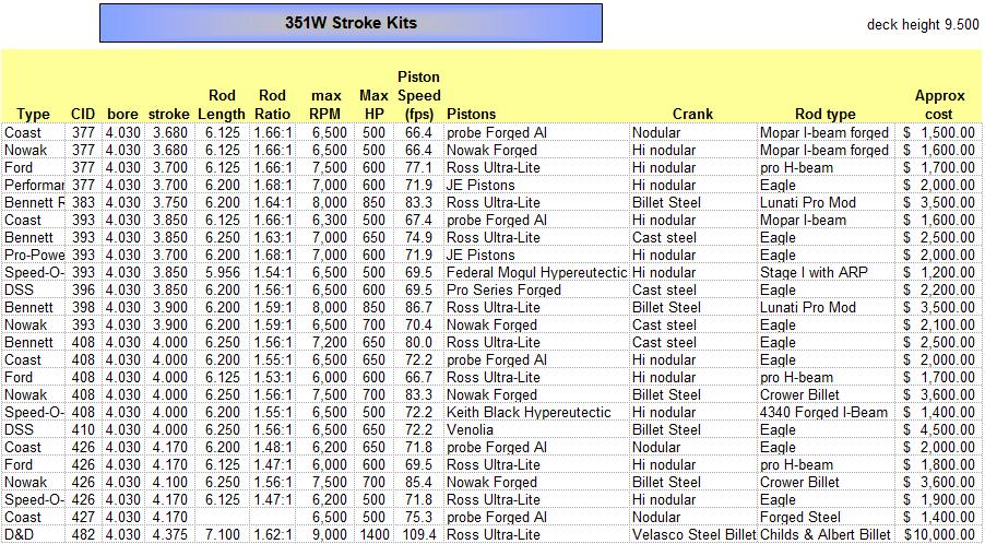

Hey Aqui,
I compiled a listing of potential stroker kits for comparision... thought you might find it of interest. The prices may be a little dated as this table is a few years old now.
351W stroker kit list.jpg (175.49 KiB) Viewed 2445 times
Agui-E7TE
Posts: 1483
Re: Need Ideas for a 393 stroker build
Post by Agui-E7TE »
Thanks Tom! That's a great way to compare the various kits available. I was leaning towards a stroker kit from Coast High Performance since they seem to be reasonably priced and seem to work really great for the Mustang crowd but I totally forgot about DSS and there stroker kit is just over $1000 and comes with a nodular iron crank, forged pistons and forged I-beam rods.
