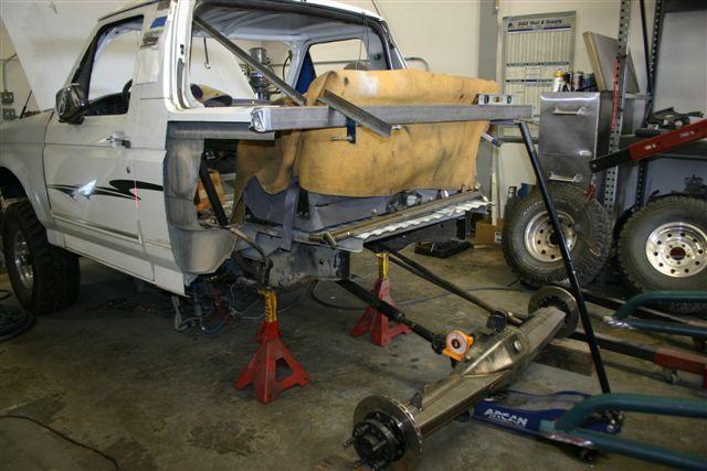

Post by PaulW »
Pickup bedsides take way more $labor$. What was done is patch panels from a JY doner Bronco. Panels for the floor, & inner and outer fender. Pretty logical since you will still need a doner even if you were to use a whole bedside. No fiberglass for mine because of the modestly wider axle. The fenders were just pushed out and rewelded.
IMG_1257 (Small).JPG (60.23 KiB) Viewed 3507 times
IMG_1415 (Small).JPG (38.56 KiB) Viewed 3507 times
IMG_1431 (Small).JPG (57.17 KiB) Viewed 3507 times
[attachment=0]IMG_1441 (Small).JPG[/attachment
IMG_1441 (Small).JPG (45.66 KiB) Viewed 3507 times

This series of pict give some idea on how the build went.
Enough for now
Paul

Paul,
Thanks for the pics! Do you have any overall pics of the Bronco? I looked through the "Rides" section, but if yours is there I missed it.

Eric,
Thaks for the pics I am a long way from SF and cannot get my laptop to connect.
Bronco is the same but has new side stripes.
BTW, the "B" pillar stretch is cheaper, but the cost difference is way lost in the total. The frame still has to be lengthened at the same place as mine. At the only flat place on the frame rails. See the pics.
Paul
