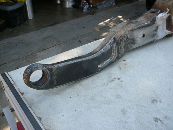

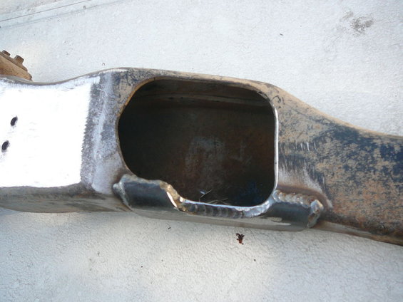

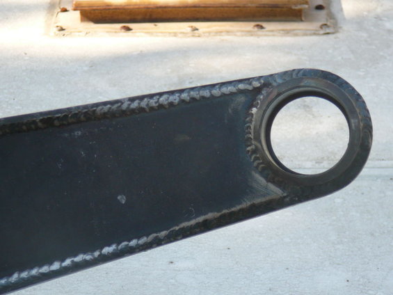

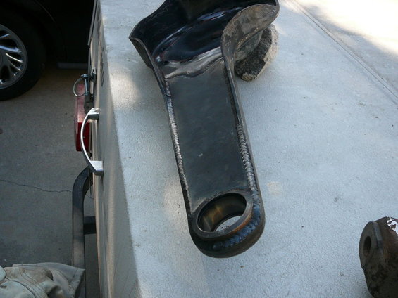

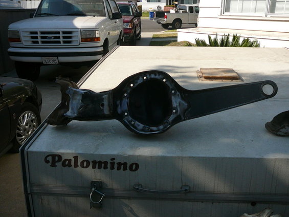

Here are some we build at our shop, good for 4"-5" of lift. Stock width and we make them in three different styles,
-Street Beams, no truss.
-Prerunner beams, trussed
-Race beams, trussed & uni-balls
