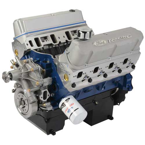

Brand new Ford Racing 460ci small block
http://www.fordracingparts.com/parts/pa ... ield=23197
