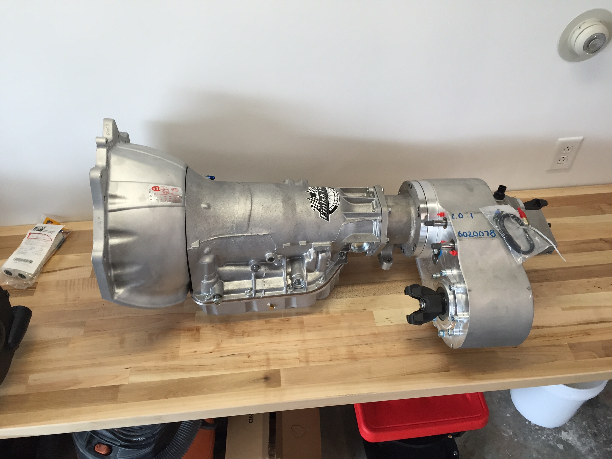

Thank you, that makes sense. I'm building a similar combo as you are and you've had some good ideas. I'm running an LS3 with a TH400 and Atlas II. The TH400 has a LS Super Bell housing so hopefully that eliminated the weak bellhousing. I think i'm going to go with similar poly motor mounts, poly trans mount, and then build a separate crossmember for the Atlas II with poly mounts. I'm kind of scared running a motor plate or mid plate with an aluminum block. Plus my long term plans are to add a 4.0L Whipple and doubling the HP which will increase the stress on the motor.

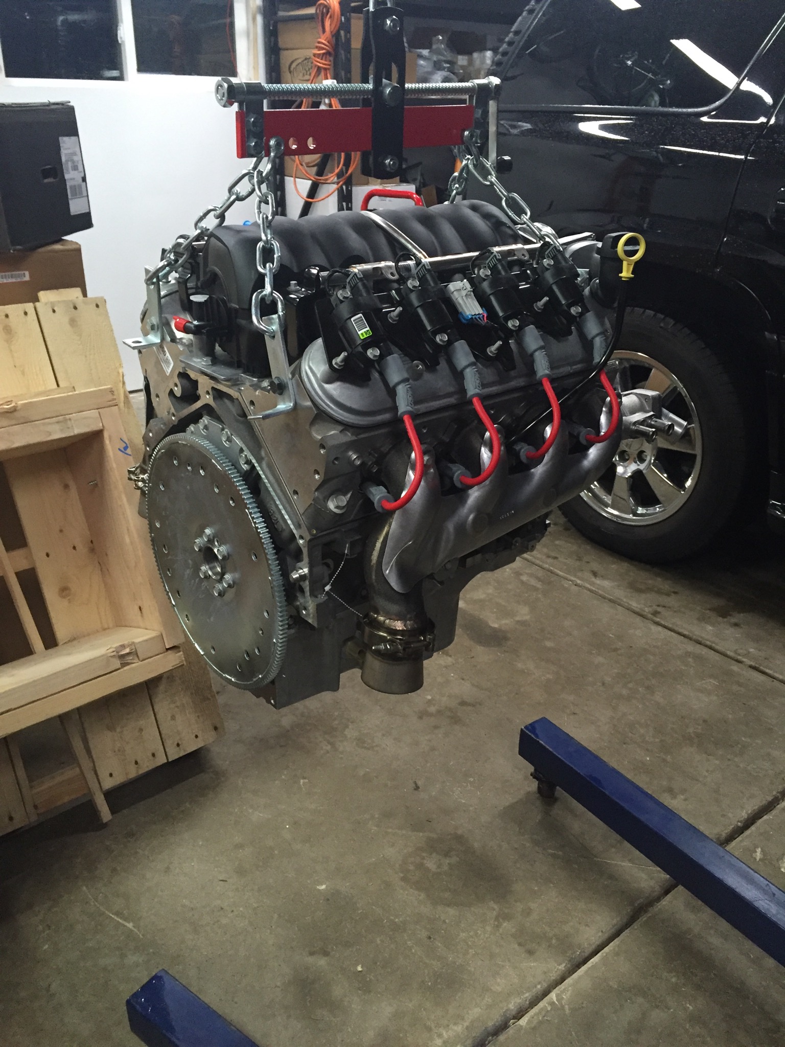

Not really much to see yet in my opinion. You could imagine tearing out a 5.0 and trans - bare engine bay and some degreasing. Then I cut the old engine mounts out and bolted the new stuff in. Then I bench fired the engine to make sure it wasn't knocking or clacking. It'd been sitting (in good care) for around 6 or 7 years. I got the engine in the bay today. There's a bunch of personal BS in here, but it has some pics and stuff attached to the build. https://www.instagram.com/sonoranguy/

I'm kind of at the same point. Degreased engine bay, LS3 on a stand, still gathering last parts to put it in. Plus mines an 81' so I want to box my frame before I put the drivetrain in. I will start a build thread once I get back on it. I moved houses and am building a big garage currently. Once I get the electric run to the garage, I will be right back on the Bronco.

God that atlas looks sweet. Why did you go with the 400 vs 4L80? Tate
- Posts: 88
- Joined: Sat Dec 12, 2015 2:15 pm
- Bronco Info: 1981 Bronco Ranger
- Location: Chicago, IL
Re: chevy l.s. engine swap vs good old ford power
Mostly cost reasons. I have only $2200 into a 1500HP rated TH400 and the 4L80 would have been more then double that. Plus the torque converters are cheaper. If my Bronco was going to do a lot of street driving I would have gone with the OD, but I'm building it for 80% dunes and 20% cruising and car shows. I think my build differs a lot from the normal trucks on this site. You guys build near trophy trucks to withstand 1000's of desert miles and some are even street trucks. For my purposes, I want a lot of power, lower weight, and stability in the sand. They are kind of similar but there will be differences in the small details. If I could get my Bronco under 5,000lbs, I would be very very happy.
