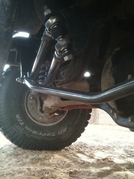

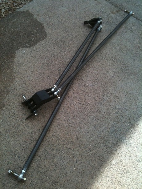

Sounds a little thin for steering. I would have atleast gone .25 wall.mesquito_creek wrote:1.25 .120 dom tubing for the tie rods

Yes, before install=straight tubesCopykat wrote:Sounds a little thin for steering. I would have atleast gone .25 wall.mesquito_creek wrote:1.25 .120 dom tubing for the tie rods
After install, bent tubes

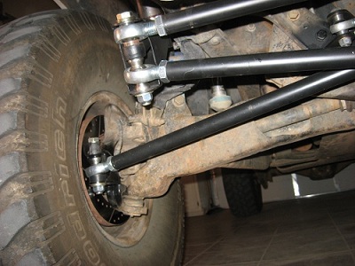

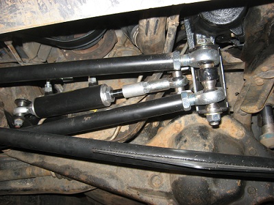

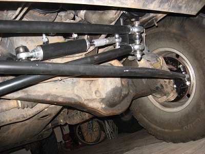

Well now I have the baja-Chris steering setup after wearing out the ambulance setup.
You know what - I can not tell the difference.
I never noticed bump steer. But I sure noticed loose parts.
If you guys can tell you have bump steer then you should have driven my truck with the ambulance setup.
Bottom line you can spend tons of dollars to emulate a race truck , but adds no value for a prerunner. What adds value is heims and fat 4130 steering tubes. And if you do that then you might as well change the links to improve a percieved attempt to make it like a race truck.
Glen has done 3 Broncos so far see the pics. Mine, Chris, & Kupec's
It sure is not perfect due to the main link that tries to droop down (see the knife edge gusset in the pic). So far we are using shock rubbers to hold it up. It does not affect the approach angle if held up. The support has to be pliable due to the angles the hiems make during articulation and turning. Any way its expensive and super strong. The passenger pivot is custom machined from a steering box part and uses lubed polly instead of a hard bearing.
Also note the ram assist whihc required a rebuilt box with ports. Found a c racke shaft and got that replaced at the same time.
So what the 3 Broncos got was a reduced cost crossover steering. No where as good as the Baja-Chris C3 build on another thread.

PaulW, you are the first I have seen to have a swinger that FOLLOWS the pitman arm, rather than swinging at 90 degrees to it. I like it! If I were to do this type of steering, thats how I would do it.PaulW wrote:Well now I have the baja-Chris steering setup after wearing out the ambulance setup.

Interesting report, Paul. I've had a nice swinger for my truck for years now but haven't seen enough potential return to sit down and build corssover steering for mine.PaulW wrote:Bottom line you can spend tons of dollars to emulate a race truck , but adds no value for a prerunner. What adds value is heims and fat 4130 steering tubes. And if you do that then you might as well change the links to improve a percieved attempt to make it like a race truck.
I like it, too.AussieRod wrote:PaulW, you are the first I have seen to have a swinger that FOLLOWS the pitman arm, rather than swinging at 90 degrees to it. I like it! If I were to do this type of steering, thats how I would do it.
I don't have a ton of experience with crossover steering systems, but what little experience I do have with it has led me to my own personal conclusion that the steering pivot points are not incredibly critical. Yes, you need to put plenty of thought into it but I think in the end (for most builds), it comes down to packaging more than "perfect" geometry. To those that argue this, I would present all the different bad ass TTB/TIB trucks that are built completely differently but still work very well. I would also present the many different theories on the pitman arm pivot... that also work well.

The thot process was long. I know Glen spent many hours measuring and jigging on the first build for Kupec. I know he never charged anyone for all that time. I think is just the love of creation. Even then the cost was great and included the ram assist and box mod/rebuild. However a full race setup would cost many time more, like the Chris C8 setup. The biggest drawback and delay was the custom machining ot the passenger pivot.

Is the passenger pivot in single shear off the frame?

Double shear For that one. Sorry about the pic res. That camera bit the dust.
GLen dosent always go double. Its all about cost vs benefit and what loads are on the joint. Double shear is not the recipe for all joints. When he goes single he uses metal lock nuts and I take them apart and add a large dia washer and red loctite. So far he has left me enough threads. (just on the 72 so far). That reminds me to bring some fat G8 washers from CO to SF.
My ambulance setup lasted several years and the TREs were and very loose when I removed them. I gave that stuff to Juan G. Maybe he can rebuild it for one of his projects?
So far I have never had to have any hiems replaced on any joint on my truck. Some are over 5 years old. Of course the steering is still new and probably only has 1-2k miles. Glen always uses the biggest heims as possible on every joint so as to minimise maintence.
How do shock ends hold up? Mine are fine so far.
