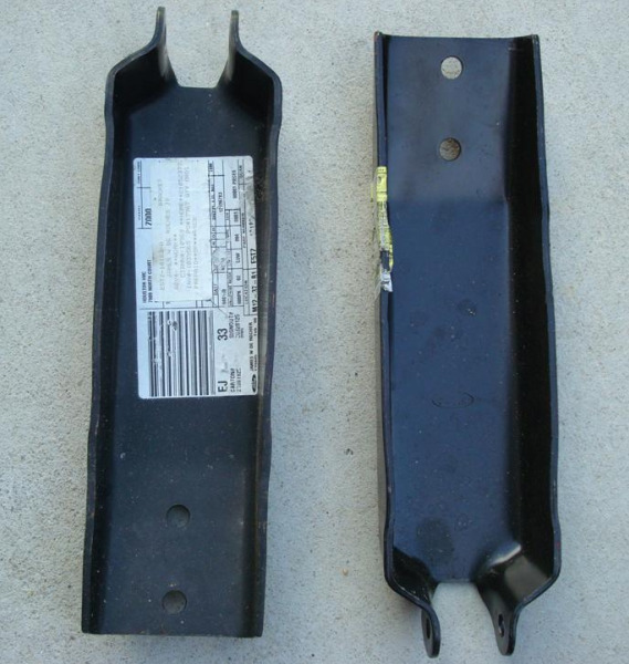

Any reason not to use these for shock mounts with my fabbed buckets?
- 4684082986_d088244b98_b.jpg (101.68 KiB) Viewed 1252 times
Re: front shock set up
I don't see why not. I think that is a great budget mod!monkei wrote:Any reason not to use these for shock mounts with my fabbed buckets?
You might be able to cut them to the height you need and weld them to the top of the coil-buckets facing to the rear of the vehicle. Then add some reinforcements the the backs of the mounts to keep them flexing.
