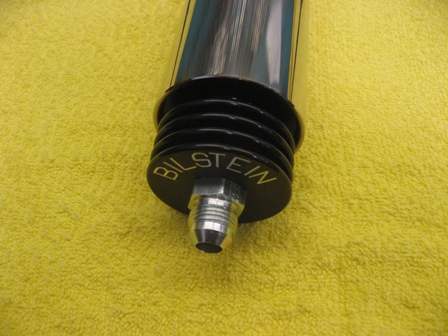

Here you go, the new ACV end caps just arrived. Can be run with or without the secondary internal valving and will accomodate piggyback or hose configuration.
Uhmmmm...Uhmmm... those look tasty!

randomthoughtsracing wrote: Here you go, the new ACV end caps just arrived. Can be run with or without the secondary internal valving and will accomodate piggyback or hose configuration.
Why would one bother running them without valving?
Lets see the business end.
