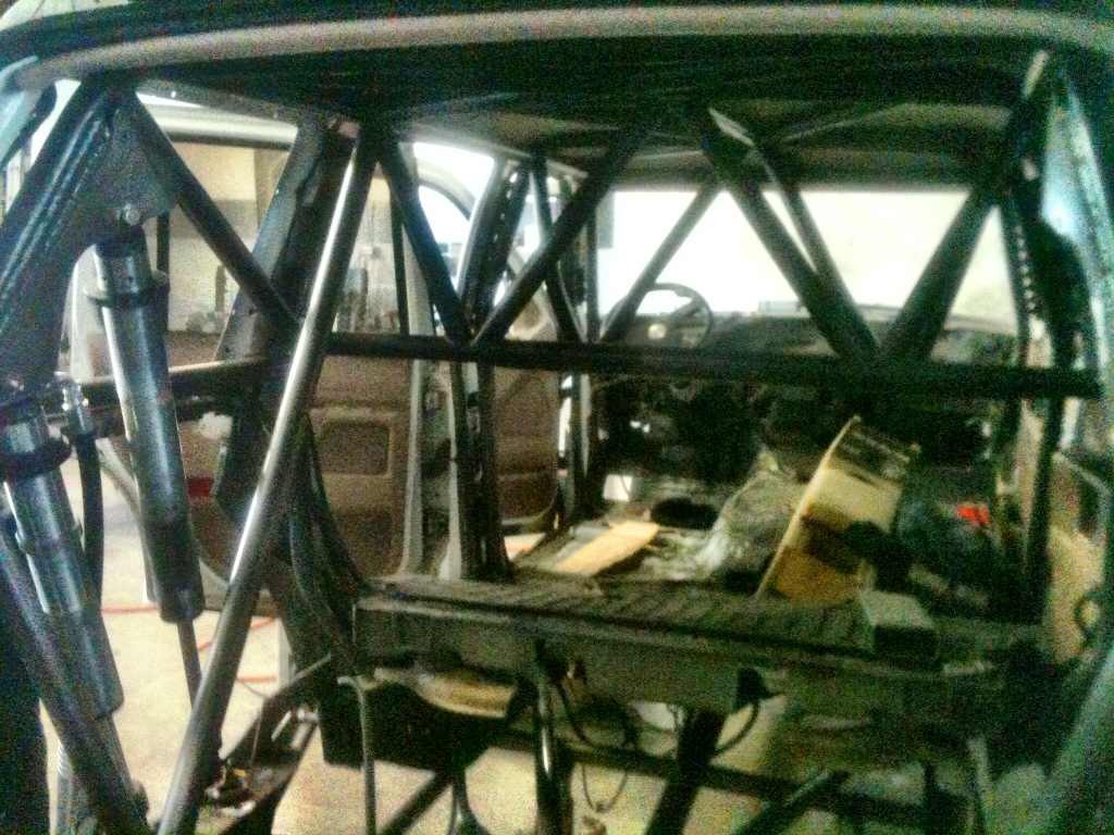

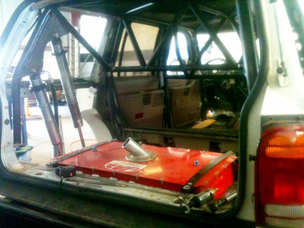

Notice dude in the first pic still has a tiny bit of shaft showing( safety margin) also keep in mind limit straps stretch on average 1 inch in length per 12 inches of strap length. Back to that safety margin keep it in mind for the droop position also. Doubled straps may be necissary,( less stretch). Straps also gain a stretch memory over time( they stay stretched out) so u can start with a 10 inch strap and it can turn into an 11 in a year.
