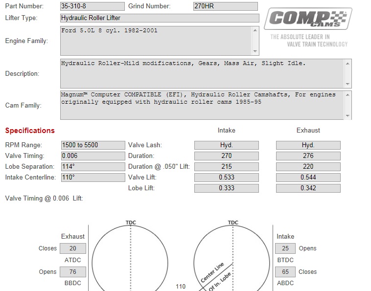

Seabass wrote:Ben, factory heads will suck on a 408. Pony up for better flowing heads
weeeeeeeeell, come to find out the factory heads got hot tanked this week and they found several small cracks. Nothing major they say, got me thinking now though.
What are my options? Looks like rebuilt heads run about 300.00 per bank. $600 - 700 complete. Built ones sell for 1K
I found these on flea bay , thoughts
http://www.ebay.com/itm/Ford-289-302-35 ... 01&vxp=mtr
My build thus far, please help me pick some heads and a reality check on my parts list.
95 Bronco, roller motor, efi
- Motor Build -
rebuild it to 408 (Scat 408 assembly kit )
Heads ??
Compcam (35-310-8) Attached the specs for reference (thoughts ??)
stock intake
shorty headers
Meiling hi-flow pump
Keeping the EFI, smog stuff
Stock fuel system
Stock ECU
anything else I am missing
thanks !

For just out of the box, bolt and go, it is really hard to beat the prices that can be had on just a set of Edelbrocks.

It might be s good idea to speak with your machine shop, If they build performance engines they can help you pick a combo for your budget...
Joe
Agui-E7TE
Posts: 1483
Re: Stroker motor talk!..
Post by Agui-E7TE »
TurboJoe wrote:It might be s good idea to speak with your machine shop, If they build performance engines they can help you pick a combo for your budget...
Joe
Agreed! All I can do is just give ambiguous suggestions on what heads to use but the reality is your engine builder would be the one to ask. GT40 heads are nice because they're iron heads and you can still likely get away with them for emissions testing. I've seen a stock bottom end 5.0L Mustang smoke the competition with Vic. Sr. heads and what I think was an Anderson Cam. The car did have a TH350 with a manual valve body and a 3800 RPM Stall Torque Convertor and 5.13 gears. That thing was crazy fast but likely only worked for 1/8 mile tracks. It was running the stock fuel injection controls with a larger fuel pump, adjustable FPR and 36 lb. injectors.

With a stock intake you don't need to go to far with the heads hence a set of #60399.
These castings will give you plenty, sure the AF is done at 0.5 but your cam is also done under 6k and your intake was tuned for 1/2 that!
All of that is ok and if you need more then have the heads CNC'd and step the cam and manifold up later.
