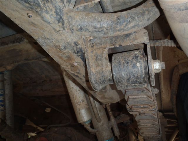

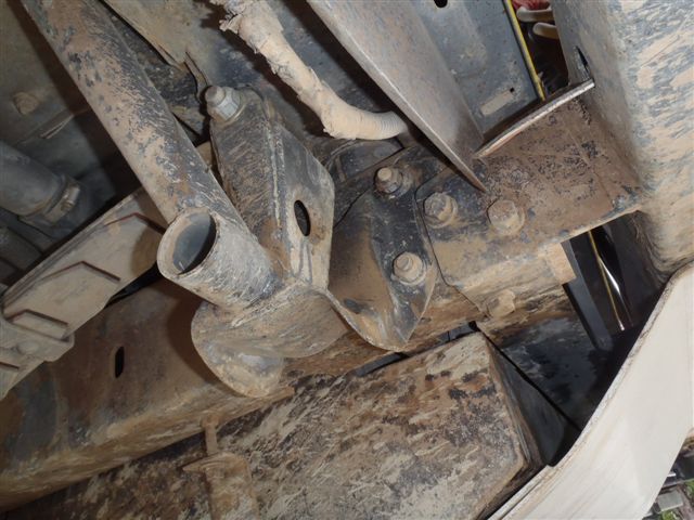

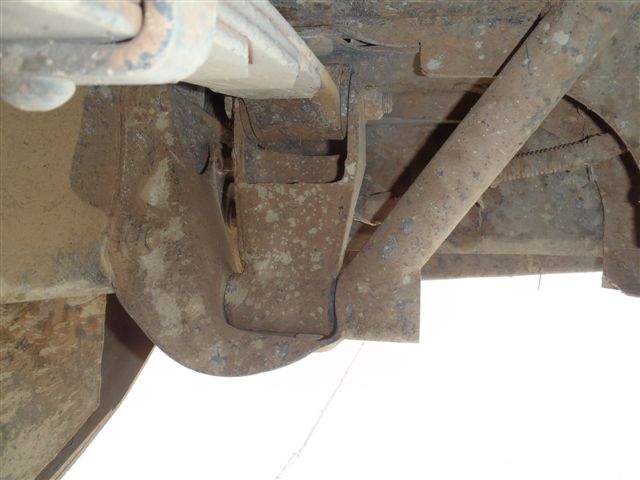

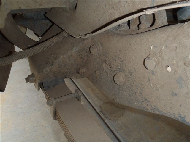

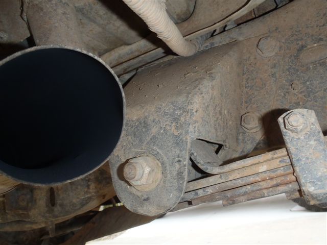

On my play truck I got tired of cracking and repairing and replacing both the front spring hanger and the rear shackle mount. For the front I had a custom mount made (stock location) and for the rear, the stock hanger is reinforced and tied into the cage, also in the stock location. I use the Autofab shackle which is an inch or two longer than stock. I'll try to shoot some photos.Frontrunner54 wrote:Once I'm done piecing my front end together... Im aiming at the rear. I am debating whether to build new hangers, or to relocate the stock ones. Planning on running a 8" boomerang style shackle... and hoping to set it up, so I'm not changing ride heighth or pinion angle.

Here's some pictures. Springs are 2.5" wide so we just built for that instead of using the wide shoulder bushings to adapt 2.5" leafs to hangers for 3" wide leafs. Pardon the dirt, grime and surface rust. It used to be all painted and pretty but I just got back from running the baja 500 course with it.Frontrunner54 wrote:Yeah pics would be cool... anyone modify or plate up a stock hanger?
- P5160610.JPG (47.12 KiB) Viewed 3127 times
- P5160609.JPG (50.37 KiB) Viewed 3127 times
- P5160608.JPG (55.63 KiB) Viewed 3127 times

Three more pictures.Frontrunner54 wrote:Yeah pics would be cool... anyone modify or plate up a stock hanger?
- P5160613.JPG (45.1 KiB) Viewed 3127 times
- P5160612.JPG (48.05 KiB) Viewed 3127 times
- P5160611.JPG (66.76 KiB) Viewed 3127 times

Looks like you gave her a beating... so 2.5s feel the road nice huh?
I wish I could build 2 gfbs at once... one with 3s, and one with 2.5s.
Thanks for the pics man. Do you have a thread on that bronco?
