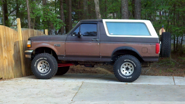

I stretched my 92 using 05 F150 springs. and got 4" of lift out of them. It moved the rear back about 3". I only need to trim the lower corner on mine. General spring has a good web site with most spring specs. That is where I did my research. I got the springs for 50 bucks apiece lfrom the wrecking yard low mileage with much better bushings. One word, smooth riding. I take my Bronco from Georgia to Colorado or Ark at the Superlift Park wheel the hell out of it and drive home. Minus a few u-joints. That seems to be my weak link right now.
- Here is what my rig looked like with the 4" Superlift #184 springs on it. It moved my rear end forward and hit all the time.
- 92 Bronco.jpg (141.4 KiB) Viewed 1588 times

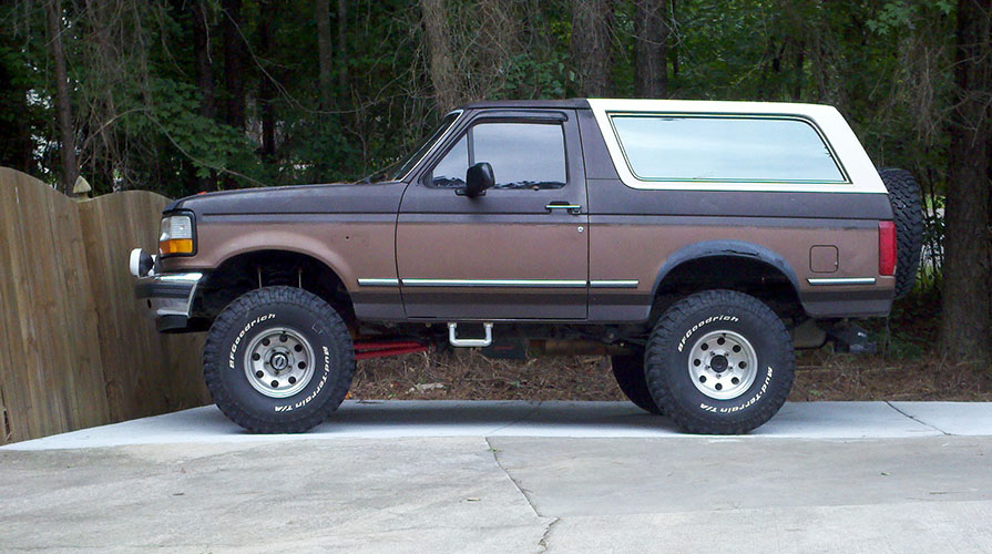

- You can see on this pic how far it got moved back. from the front. It use to hit before.
- 2012-04-29_11-16-14_253 (640x361).jpg (147.76 KiB) Viewed 1588 times

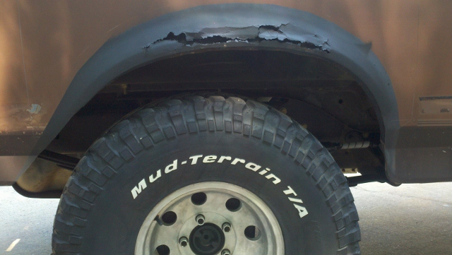

- did a little trimming on the lower back of the fender. I am in the process of replace the body rot courtesy of Florida when I lived there.

Forgot to send a full view after pic. It rides much nicer on the freeway and steep desents feel safer.
- Forgot to send a full view after pic. It rides much nicer on the freeway and steep desents feel safer.
