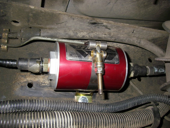

ChaseTruck754, check out this Canton Racing Products CM EFI High Flow Fuel Filter (PN 25-910). Permanent, does a good job and easy to replace the element.

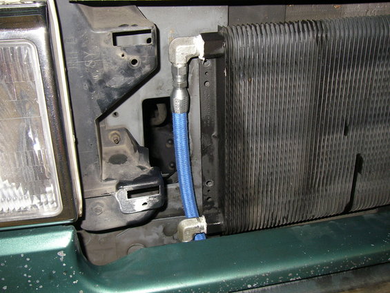

Here is my Level 10 thread: Seattle FSB Level 10 PTS Bulletproof E4OD
Custom Level 10 Bullet Proof E4OD
Old Level 10 Billet TC - 1800 Stall
New Level 10 Billet TC - 2500 Stall
Perma-Cool Remote Trans Filter
Flexible Stainless Steel AN Lines
B&M Racing 29,200 BTU Transmission Oil Cooler
Mag Hytec Trans Pan - (16 + 7.5 quarts Amsoil ATF)
Trans & Diff Temp Gauges
1990 FSB, MAF, 6.7L, Level 10 E4OD, Currie F9, ABS Electric Brake Booster

Seattle FSB wrote:ChaseTruck754, check out this Canton Racing Products CM EFI High Flow Fuel Filter (PN 25-910). Permanent, does a good job and easy to replace the element.
Thanks for the recommendation.
Here's a link for others who may look into this
https://www.cantonracingproducts.com/cg ... key=25-910
