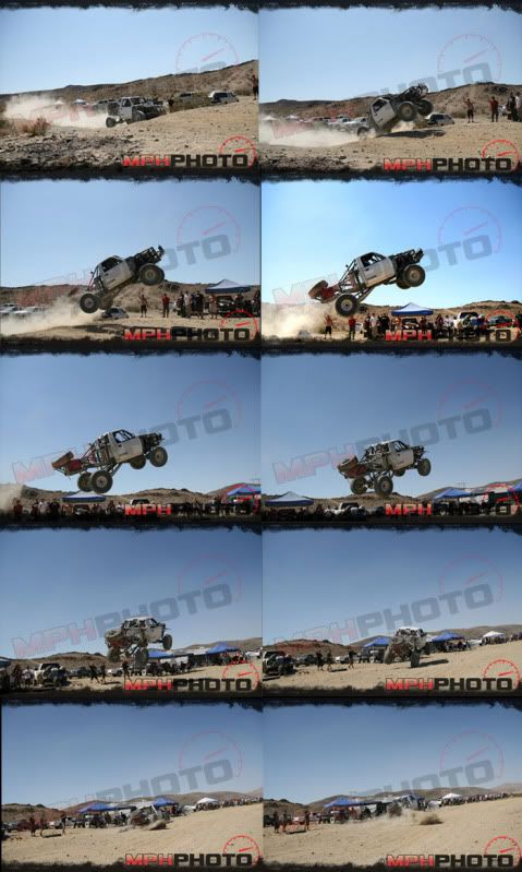

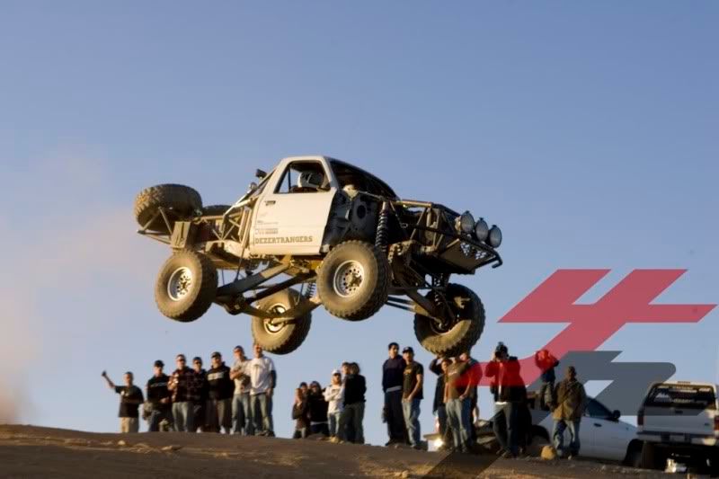

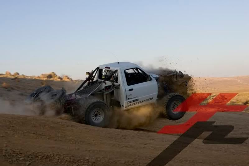

I ran GIANT suspension of my old race truck.
NEVER have a suspension failure
If Geoff released a product for sale, I would trust it on my ride. Even dun dun dunnnnnn drop brackets.

Mike, thats some awesome air!

Dude! Those are some sick-pics! I liked the first one, third one (massive earth scoop rebound) and last one the best. Can't remember if i saw em before on DR or somewhere but those are coolonly1mikey wrote:I ran GIANT suspension of my old race truck.
Mike

Mikey, we all know those are photoshopped. Everything would have broken in half or three pieces.

Holeeeeeeeshit that some air....Great shots mikey...Back to ths subject at hand. Ive known Geoff personally for close to 20 yrs.(Dam its been that long) Kylegorter comments are correct about him being alittle "off the wall". But thats what makes him Giant Geoff. I think he was the first to bring the "WIY" kits. He also took small time local racers from across so-cal sponsored them and made them feel part of a factory team..Pit support,tons of free goodies,webpage with team members... He has definatly had many set backs when it comes to design and build, but that just comes along with territory! Especially when you start to thinkn outside the box. His products have come a long way since the begining. But as mikeys pics show they are race proven!... Geoff has always been a good guy and good friend and has done alot for the desert race community. Love him or hate on him, it dont really matter he will continue to be "aliitle off the wall"!..But then again thats just my 2cents.
