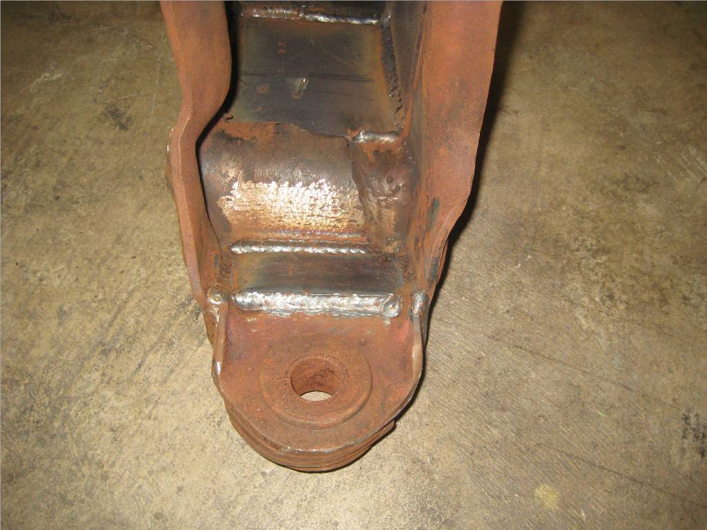

Cutting the lower balljoint ear and moving it out, is the most common way..
Cut and turn questions?
1,000s of trucks out there done this way. It shouldn't put any additional stress on the ball joints.
