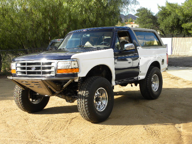

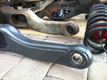

Its not as easy as 123 but its definitely not rocket science. If you don't build the beams correct you will run into problems..Last thing you want is your axles binding up or worse yet having to force the snouts on after you put your axles in. Everything should go back together nice and smooth. You don't want your balljoints to be at extreme angles unless you don't mind changing them out all of the time..Zero degree cams are what you want to aim for. With a Leveling coil you are going to be maxed out on the cams which is not a good thing. Also If you plan on clocking the 3rd make sure you build the beams to allow you to do so, or its not going to work. You cant clock a beam after the fact or you WILL have problems with your axles. If for some reason you end up not wanting to tackle it yourself let me know. My kits are pretty affordable and the quality is as good as it gets. I also offer a lot of upgrades and have a few added benefits that others don't. I have been building TTB, extended 2wd beams, and equal length beams since 94 so if you have any questions feel free to ask. Keep an eye out soon for my own personal Bronco build. I will start a thread on it as soon as I get more time to work on it. :D

Threat Motorsports wrote:I also offer a lot of upgrades
I might have seen a set of these layin around the house :)
Threat Motorsports
Posts: 346
Bronco Info: 95 Bronco SOLD!
Location: UTAH
Re: Long travel for 1980 bronco?
Post by Threat Motorsports »
Actually I think I have seen a pair at my place :D
Did I see that Bronco down in Irvine on Bake/Jeronimo or somewhere down there?
