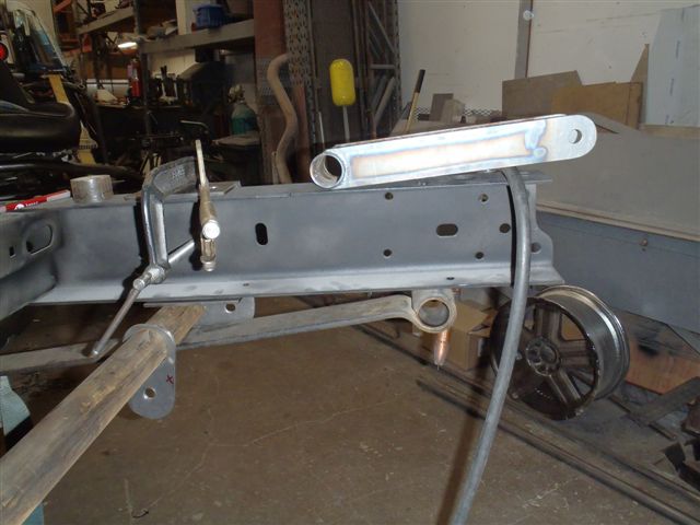

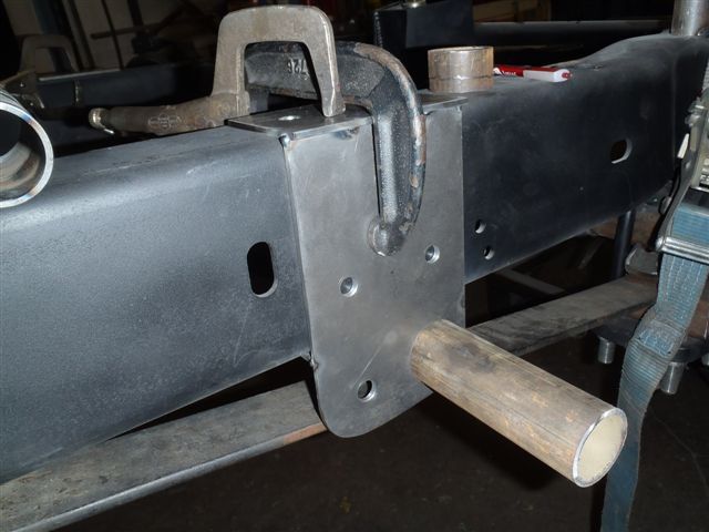

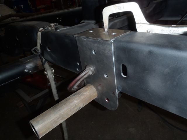

Cut up a bunch of 3/16" 4130 plate to make the four shackle hanger brackets (and the front radius arm pivots which are in another thread). The rear shackle bracket gets a cross member under the frame. The front one will have to do without since the rear links use that space, instead they will just tie into the cage.
