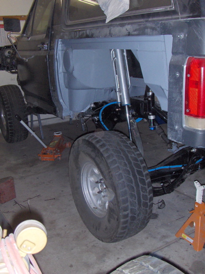

I have the Giant 64 kit on the bronco I am in the process of building. I got a longer shackle from giant bringing the ride hight down then notched the frame (2.5-3" I forgot) and floor crossmember to gain the up travel back. I am getting 22" bump to strap. The spring just hits negative arch maybe 3/4". The drive shaft is the big limiting factor. 19" the drive shaft is max with out notching the frame. Some times you have to ask yourself is it worth more of my time/work/money and frustration for a couple inches? Just my 2 cents Ill let you all know how it works once the rest of the build is done.

I needed to do the two link thing.... The first two times i drove my bronco I broke the lower driveline u-joint each tome. After 2link.... 3 years same u-joints in the driveline. (before the 2link I could just make out the clang clang clang binding)
trac barz.jpg (87.14 KiB) Viewed 2113 times
Re: Giant Motorsports FSB 64" springs kit or deavers
What are the specs on that link set u? Is that based on the giant kit? More pics please.

cs_drums wrote:What are the specs on that link set u? Is that based on the giant kit? More pics please.
ya It's a Giant 64 kit. I love it. I've modified it over the years... fixing cracks, and gusseting, and what not. imo the best setup to start with if your shocks are going into the cab.

Post by RSR »
Ryan
Do you have a picture of that from the inside?
Post by fordf100amc »
Ryan. Nice set up. How long is the shackle? Do you have any pictures of your shackle setup up close
