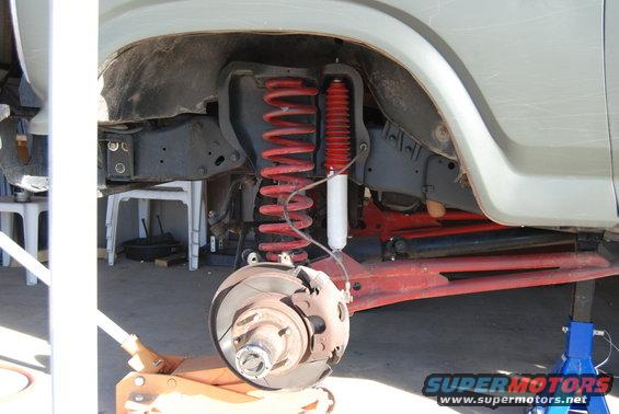

- bajascott
- My belly is my best friend
- Posts: 2006
- Location: southern oregon
Re: help me find shocks!
modified coil buckets work very good if you are on a buget and dont want to spend the money on custom buckets. i did mine with the shock in front of the coil.i wouldnt change a thing on my set up(allthough coilovers would be nice)
- DSCF3558.JPG (100.89 KiB) Viewed 2121 times
