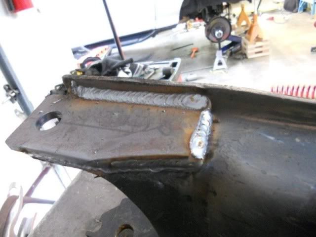

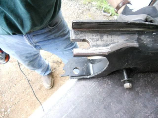

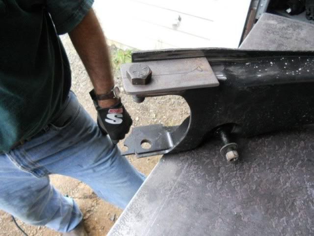

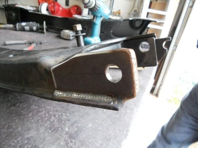

So here's my caster fix. Took the route BajaScott suggested and it worked pretty slick. While the truck was on level ground I unbolted the bottom radius arm bolt. To my surprise the bottom of the beams rolled forward very easily. I had a angle needle gauge on the front of the beam, and I pulled the bottom forward 7 degrees. That moved the hole 1/2" is all. So then I pulled the arms and did the following.
Only took about 2 hours to do from start to finish. The truck has 7 degrees caster with zero degrees at the bushings.
So using the super duty radius arms on my setup with 4" Rancho coils in the front, I had to move the bottom radius arm bolt 1/2" forward to correct caster.
To address the bushings, they have seemed to settle in nice and I'm going to hold off on uni-balls. The only time they seemed to be really stressed is past full droop, my droop being limited by the 5100's, it's not currently a problem.
So there's my experience with these arms, I think they're a great option for the Broncos and F150's.
