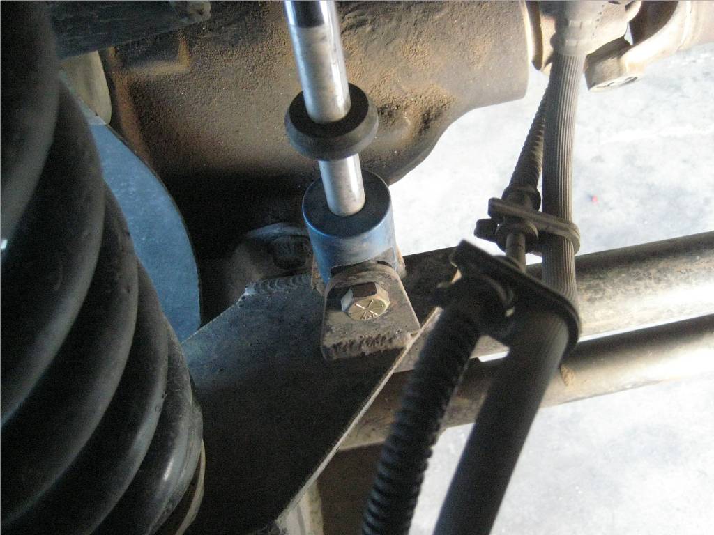

Can the lower shock mount go on the side (closer to tire) of the radius arms or is there a reason most keep the mount on top? I ask because in XJ's mounting the shock to the lower control arm changes the handling vs mounting directly to the axle.
Current setup:
Before Baja, I installed a homemade C&T beam and extended radius arm kit I bought from a guy online. He included coil buckets (custom), extended radius arms and 10" fox shocks. The lower mount is on top of the radius arm and the upper mount was built off the top of the bucket. I already had to move the upper up further due to insufficient up travel. Well, the 10's suck and I scored some 12's.
Current setup:

Hmm I am curious what is limiting the travel for you with 10s usually a 10 off the rear like that will pull the same travel as a 12"up front on the beam with that being said I dont see why you couldnt move the mount to outside the radius arm as long as your tires will clear at lock which I suspect they wont. It may be better to relocate the upper mount?
Any idea what is limiting the travel for you besides shock length? also have you checked to see where your axles are at at full droop mine are strapped at nearly the max angles? Just some ideas to look at....the other option would be to use the 12s up front off the front of the beam I personally have not seen an application where 12s were used behind the the bucket but that doesnt mean it cant be done.

Your upper mounts should be located where the collapsed shock is at full bump. If your shock is bottoming before you hit your bump stop, then you need to move your upper mount up or lower mount down. If it's already setup correctly at full bump, then leave your mounts and you'll just gain 2" of droop.
Re: Shock mounts on radius arm?
Hey Andy, if you mount it on the side of the radius arm, between the tire and the radius, isn't it possible that as the radius arm droops, the fact that it arcs a little like this ( , then it could potentially hit the shock shaft... just something to watch out for.
I like Jeremy's suggestion, change the upper mount.

I understand how to cycle suspension. The 10's are non-res and won't hld above 60psi. I would rather upgrade to 4 month old 12" res's than deal with the 10's. I thought about in front of the beam.....maybe I'll look into that.

Yeah, I already re-did the upper mount once. hahatcm glx wrote:Hey Andy, if you mount it on the side of the radius arm, between the tire and the radius, isn't it possible that as the radius arm droops, the fact that it arcs a little like this ( , then it could potentially hit the shock shaft... just something to watch out for.
I figure to do it right I would need a tube shock hoop.....if I'm gonna hassle with that, I might as well deal with coilovers already too. haha Not quite ready for that cash outlay.

I'm thinkin of doing the same thing with mine. I went to the rear of the bucket and mine are too long so I thought I could trim the flat plate on the top of the rad arm and mount the bottom of the shock to the lower arm.
The angle of your tabs is wrong. They should be parallel to a line drawn from between the two pivots at 90 degrees.
You can mount anywhere you like on the arm but be aware the brake caliper gets close at full lock and tires like to get close to the shock sometimes. The closer to the wheel the better the control the shock has but it also reduces the travel.

Good catch!! I didn't even notice that.....something else to fix. hahaphilofab wrote:The angle of your tabs is wrong. They should be parallel to a line drawn from between the two pivots at 90 degrees.
