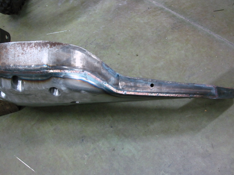

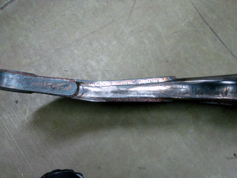

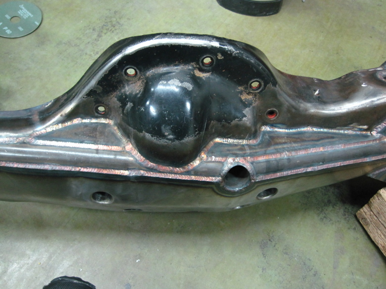

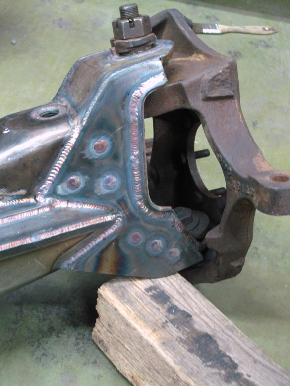

Just finished the front beams for my race Bronco, you will notice a few differences from your stock beams.
gunit
Posts: 340
Re: Start Your Go-Fast Build-Front Suspension
Post by gunit »

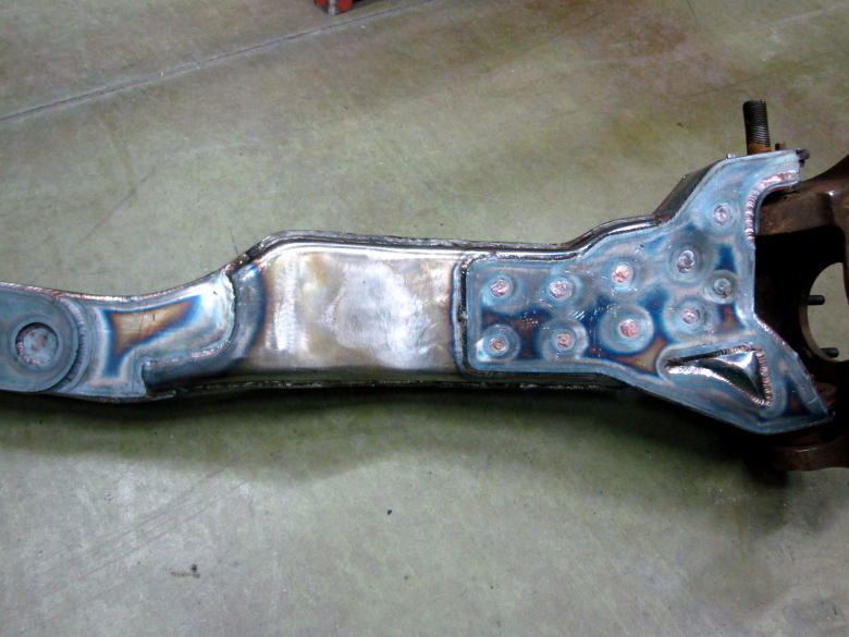

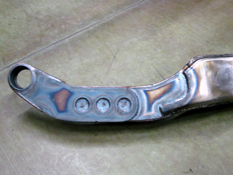

The other side
IMG_0470.jpg[/attachment attachment=0]IMG_0471.jpg

A few more

I assume from the pics that you are getting camber correction from the kick in the beam instead of from pulling out the lower ball joint. Does this give you more up travel? Also, how does this affect the center slip yoke in the driveshaft? Looks like it might cause it to slide too much from full bump to full droop. Not being critical, just asking questions :)
gunit
Posts: 340
Post by gunit »
We have gone this way for several reasons: better angle of the center joint, better steering geometry and more up travel and less change in camber between full droop and full bump compared to C&T. Both of the pivot points have been relocated as well.
It is not the way everyone elso has been doing it but we feel that we have made the best compromises to achieve the maximum performance within the confines of the class 3 rules.

Can you elaborate on the relocation of the pivot points. Is the track width widened, and if so, where does the extra width come from. I'll bet you get about 2" more up travel without the extra ride height.

gunit wrote:We have gone this way for several reasons: better angle of the center joint, better steering geometry and more up travel and less change in camber between full droop and full bump compared to C&T. Both of the pivot points have been relocated as well.
Super you can be proud of what you have done. You have beams that are stronger the Chris' old C8 truck. Workmanship is excellent as well as the plating.

I will post more pics showing the swing when the radius arms are complete.
Paul, thank you. We spent some time studying that truck as well as several other successful TTB racers.

looks awsome. i am wondering how much ground clearance is effected.i was contracted to build a front end for a friend of mine,and he wants the beams to be set at stock hieght and 4"wider per side. we were talking about how the bump travel will be affected so he was goint to notch the frame. but i never really thought of relocating the pivot. i will be watching your build,and learning something new!
Two thumbs up!! So awesome to see people being innovative and looking at different ways to get the suspension to work. What are your anticipated bump and droop numbers?

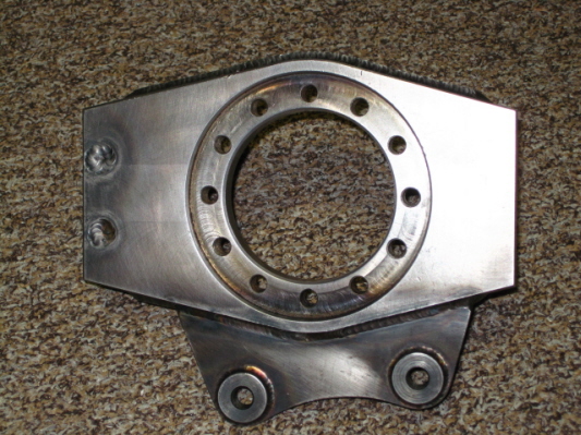

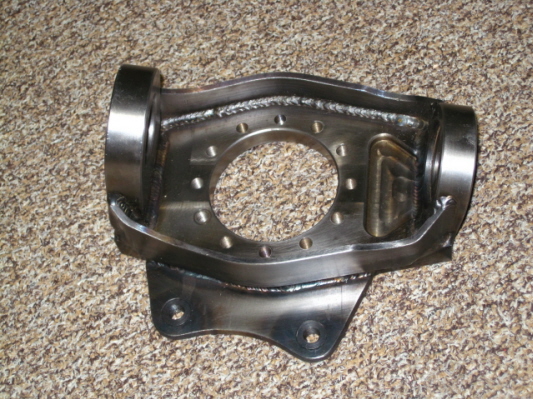

Looks good ! It looks like you are using older 78/79 style uprights and spindle combo on there? The ttb pieces look a little small after working with the 79 stuff so long. I was planning the same for my project.
Ken
gunit
Posts: 340
Post by gunit »
MOSS2 wrote: Looks good ! It looks like you are using older 78/79 style uprights and spindle combo on there? The ttb pieces look a little small after working with the 79 stuff so long. I was planning the same for my project.
Ken
Ken,

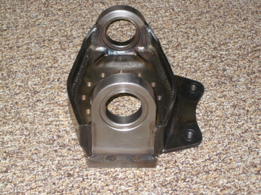

I am using these uprights:
