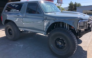

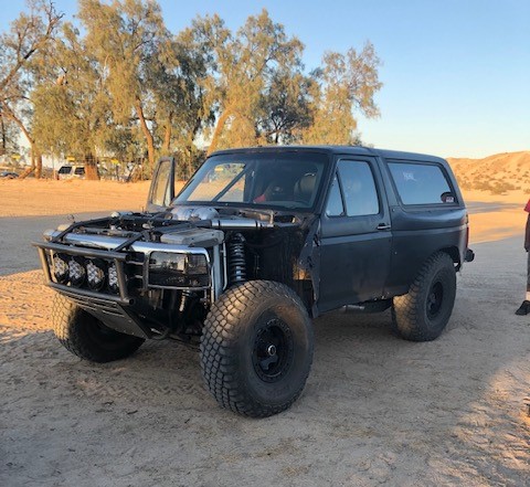

The swap has been repetitively easy for this bronco. the owner is a LS guy tho
LS3 525 with GM standalone harness OBDII 3 wires to make it run. order from GM
4l80 culhane manual
NP205 ford side drop drive-line
custom radiator lines
you need to use the correct oil pan for the swap.
custom intake
headers can be custom or block hugger style
Autofab makes mounts for our bronco 1980-96. I know a few guys have used them. Bret made his own mounts on this bronco.
I think that the basics.
you will gain drive line length and have overdrive. you will need new drive lines made also forgot that one
Johnny has done the swap as well on his blue bronco, I think Vik the builder used autofab mounts but he can chime in.
4l80 culhane manual
custom intake

- funinthesun95
- Posts: 1701
Re: LS3 Swap Questions
she just got Paint as well.
