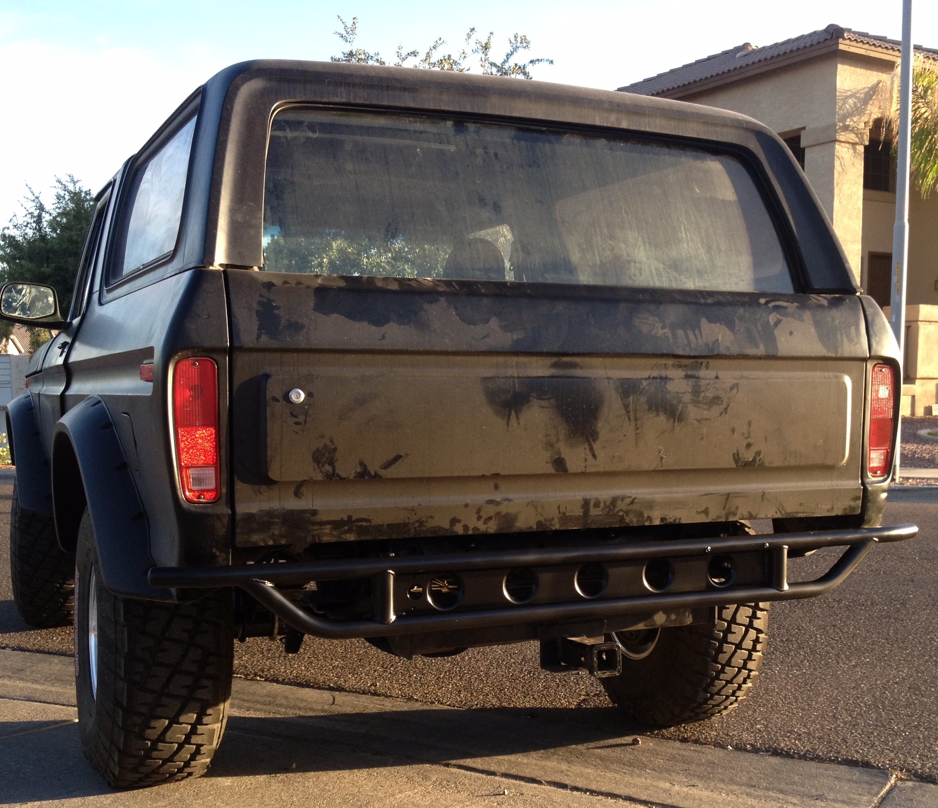

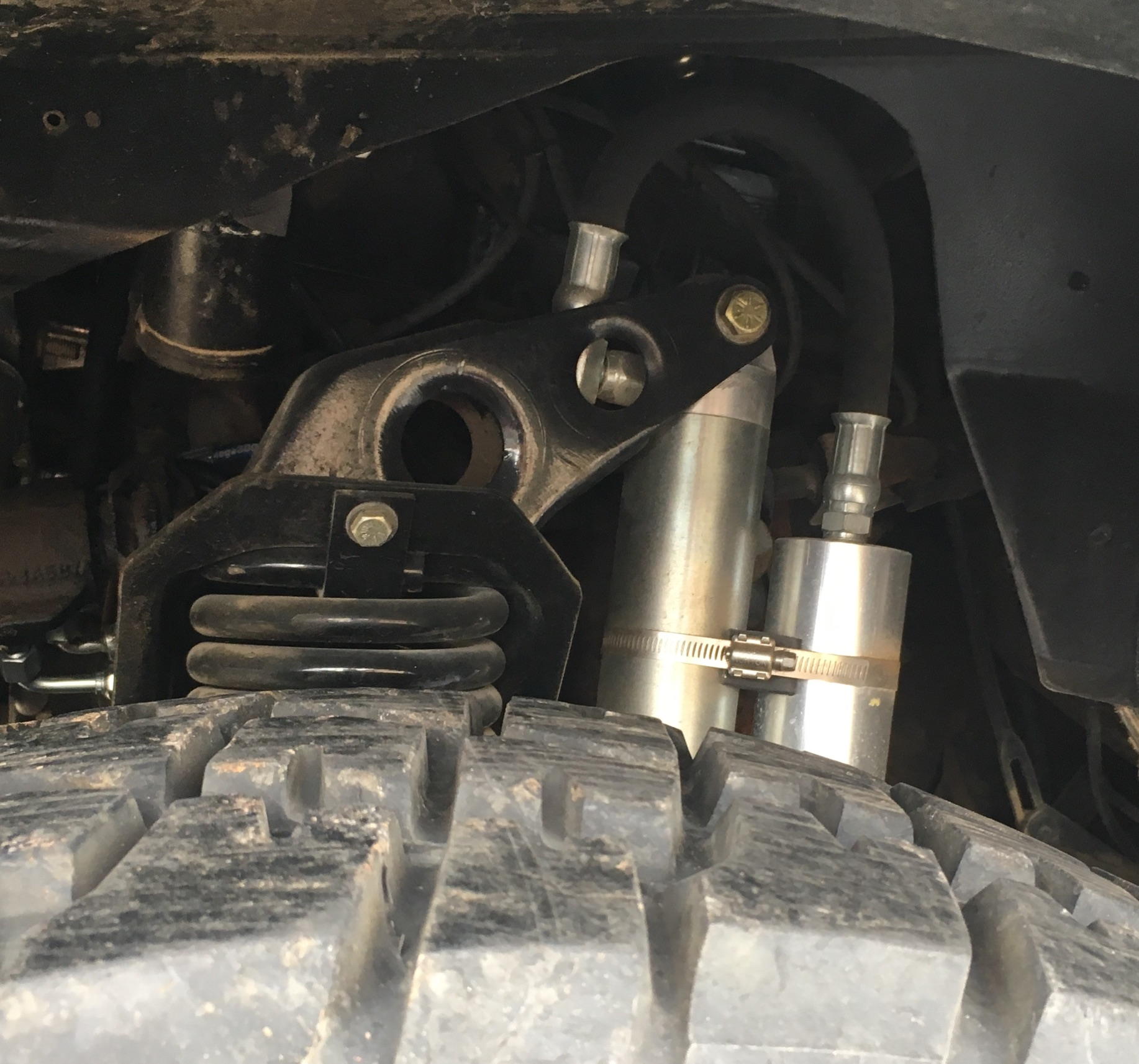

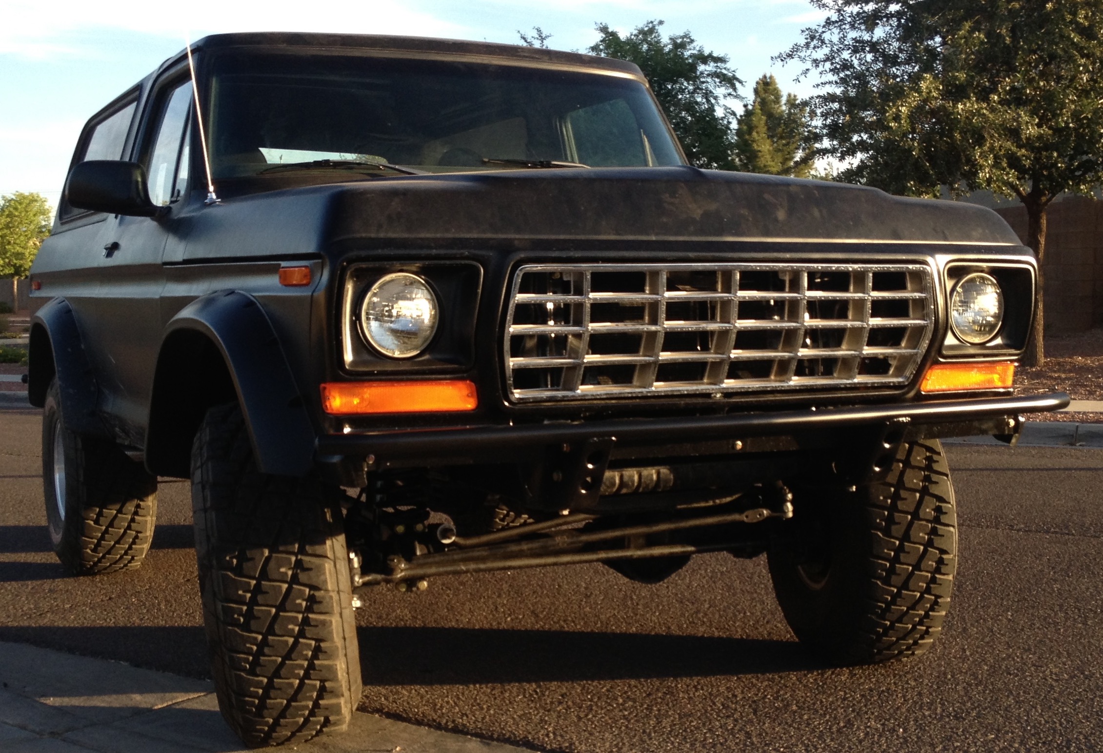

Just an idea of what mine looks like on a 2.5” front and really nothing over height rear. Those radius arms I built are 12” longer, with a 12” shock.

I think the flares Help on yours. As I think that looks good
