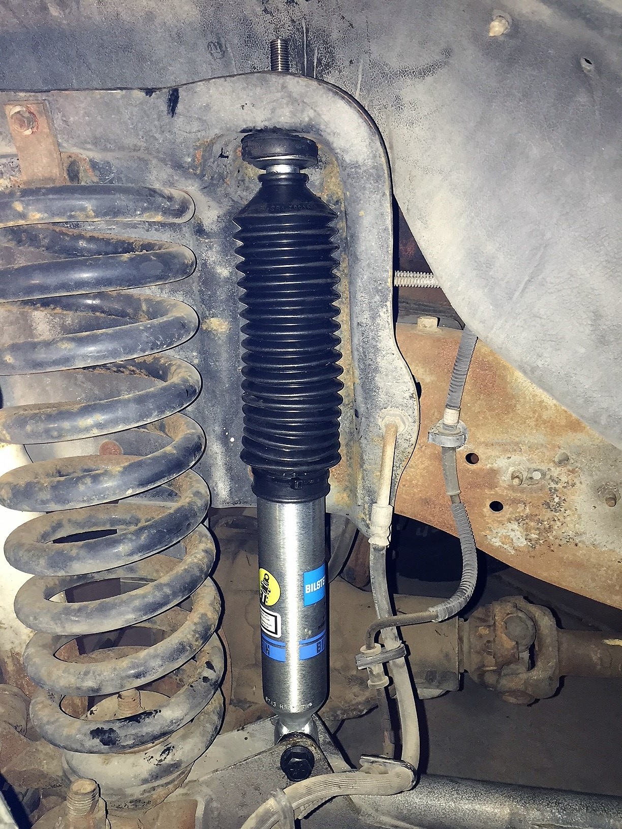

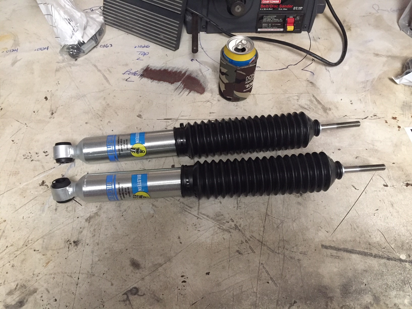

Installed the 5100's yesterday. Feels much better!
I don't really like the top mounted shaft bushings. When tightened to a slight squish, they feel loose. Mushroom city if you torque them to spec as Bilstein states. I wonder why they don't include a thin wall sleeve as a torque stop...

Some F250 shock towers will fix that, use the same style mount as the beams do, and will allow you to run a longer shock. Btw that's some crazy lookin rear shock mount /track bar..? setup you got goin on there haha looks interesting

LOL! Right!? That shit is in a pile now. Hideous!zachwabbit wrote:Some F250 shock towers will fix that, use the same style mount as the beams do, and will allow you to run a longer shock. Btw that's some crazy lookin rear shock mount /track bar..? setup you got goin on there haha looks interesting
