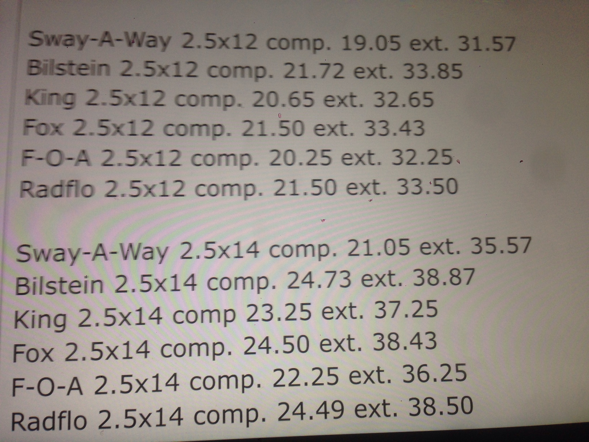

I got this from a GFB guy here and the shocks are 2.5x14, does this look like a long enough coil over?? It only hangs about 10" below the frame rail? They I figure there is no droop if I go with what I have? Or is the tab on the beam need to be tall? I'm confused!! Jason

Correction these are 12" Coilovers. Do these buckets call for 14"??? Help!!!!

The person I got them from says it calls for 12". Have a fab buddy looking at them now who says 12s are going to be short and will have no droop.

SWP uses a short body 14" fox or bilstein shock. 12's can fit but may limit travel vs the 14 inch stroke.

I'm guessing this is where my 2" is....am i on the right track thinking that fox or Bilstein would work in a 12" but not sway away??

No. Fox and Bilstein make a 14" shock in a 12" can. You can get additional length by changing out your rod end on the bottom for additional length but it will not give you additional travel.

Just like Bray mentioned, I've got a set of 12" stroke Bilstein 8125 coilovers that I was running with my SWP buckets that I'm going to be listing for sale this week. They've got the AGM sliders, and I also have some 500lb lower Hyperco coils as well. The measurements on the shocks are 21.5" compressed and 33.5" extended.

From all the info I got today from what I understand is 12" will "work" HOWEVER it not the optimal size and 14s cycle the travel much better. There are some super smart people on here that explained it very well to me on the phone!!!

So to touch on this 14" shaft with a 12" body deal I would try to avoid it personally. Run a 14" package. The reason I say this is because after extensive conversations with fox and design guys in order to run the 14" shaft in the 12" body the remove more than half of the shaft support inside there for if you run any valving you risk binding and bending shafts at full droop. I do not know what Bilstein has done on the inside. Many guys have had great results but this is what was explained to me by one of my best friends that was the Fox shock guru.

Interesting you say this...my Neigbor fab buddy who builds trophy trucks said the same thing. He wasn't a fan of the short bodies and says run a full size 14" with limit straps and bumps to get full range of the shock. I have a great option of buying some Bilstein 14 short bodies or just ordering new fox 14s. Not sure how to play it.
