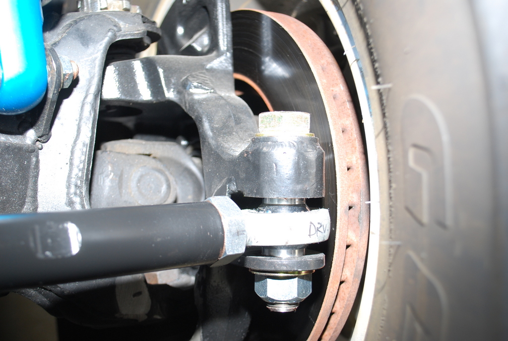

I'm gathering parts for swing steering and I just went through this thread without really seeing mention of it, but what are you guys doing for bolting the outer heims to the knuckles? Someone mentioned Fodrill pins once that I saw but their website isn't working. I know a lot of you double sheer the knuckles, so once you do that do you not worry about the taper in the knuckle? With the heim steering on my current A-arm Explorer kit I have a machined tapered pin. Also on the same kit, I adapted a uniball to replace the lower BJ by drilling the taper out of the knuckle and welding in a straight sleeve, so that could also be done for steering. Thanks.

Not sure how to edit my post but I want to add this picture from Solo's site, and they've welded something to the knuckle but make no mention of any modification to the knuckle or any special tapered hardware.
Steering Systems - Stock, Superunner & Equal Len. Crossover
I drilled out the taper and pressed in a sleeve for 5/8" bolt.
Re: Steering Systems - Stock, Superunner & Equal Len. Crossover
cs_drums wrote:I drilled out the taper and pressed in a sleeve for 5/8" bolt.
I drilled and reamed for a 3/4" bolt....cuz I was too lazy to machine a sleeve, but it works great with a 7/8 heim. Less time and no misalignment spacers.

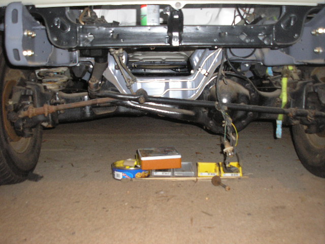

I'm glad mine is RHD, the steering isn't far off being ok. No need for upgrades other than a tierod flip:
Posts: 2338
What in the hell does a RHD steering box look like?
Posts: 2821
VintageIronFab wrote:What in the hell does a RHD steering box look like?
Like this:
