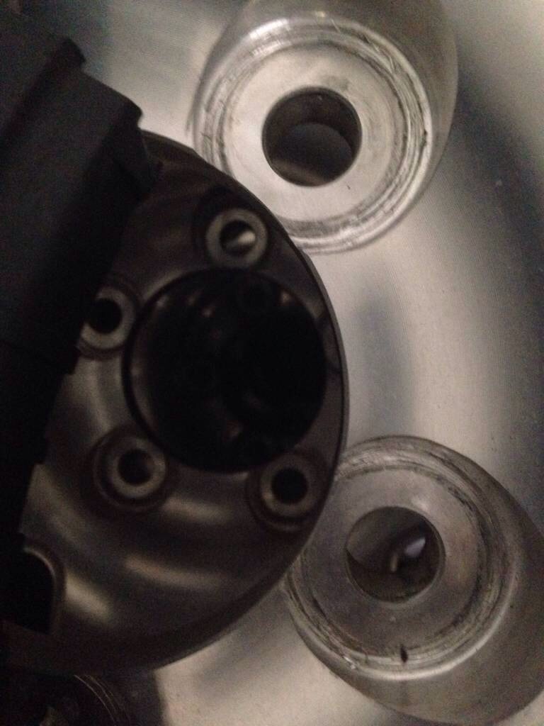

Re: 5/8s Wheel Studs
[attachment=-1]uploadfromtaptalk1402161381055.jpg[/attachment]
I thibk these can accomodate a washer

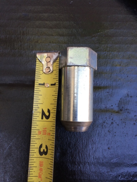

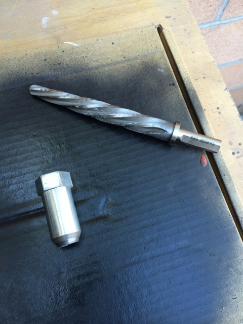

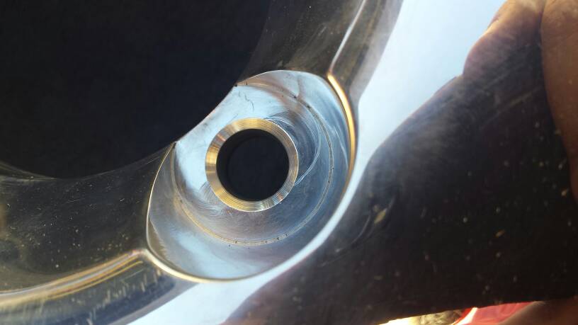

I bought an 11/16" construction reamer and these lug nuts for my American Mojave wheels. They seem to work fine, I've rolled it in and out of the garage several times
I can't remember who made them, it was a Toyota guy in central California. Trifecta? I bought all he had, which is just enough. I wouldn't mind some more.

Sorry, forgot the pics.
