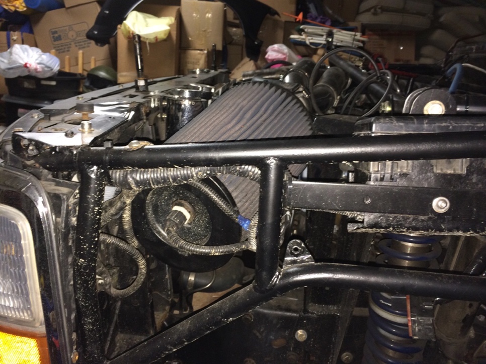

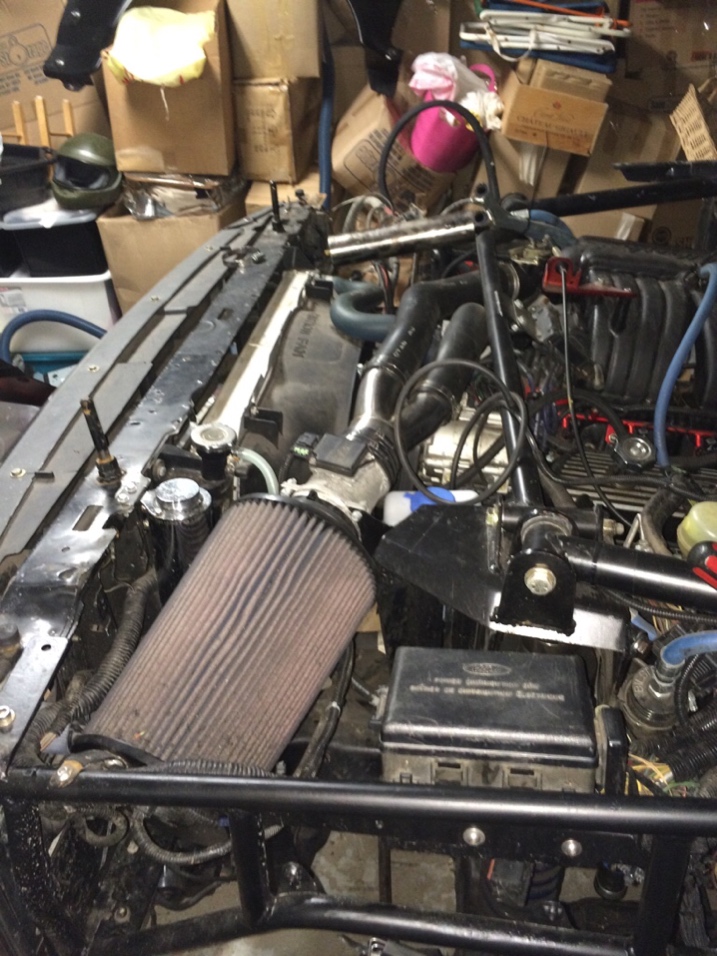

What filter set up are you using? I know if your 400-500 hp it will require one large filter or 2. With shock hoops and engine cage it kills the space in there. I am in the middle of trying to find something small enough to fit to handle that hp range.HOONracing wrote:So in our race bronco we are running a 351w roller with a stock bottom block out of 1997 f250.

I had plenty of space, so I put in a comically large K&N filter in. I'll try and snap a shot of it for you when I get home.WCCStrokinItRacing wrote:What filter set up are you using? I know if your 400-500 hp it will require one large filter or 2. With shock hoops and engine cage it kills the space in there. I am in the middle of trying to find something small enough to fit to handle that hp range.HOONracing wrote:So in our race bronco we are running a 351w roller with a stock bottom block out of 1997 f250.

Here you go. Comically large air filter.
