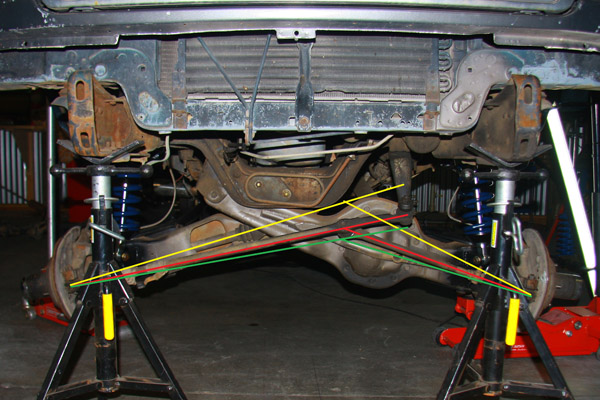

Post by Agui-E7TE »
I've discussed this with other members on here in the past and was hoping we could see some pictures of people's steering setup to see how they work. Here's a photo to show what mine looks like with a drop-pitman arm.
Lets see more...
Agui-E7TE
Posts: 1483
Re: Drop Pitman Arm or Stock w/ C&T
Post by Agui-E7TE »
The yellow line is what I would arbitrarily say is where stock would be. Red is with 4-inch and green is with a 6-inch drop.
You remember augi I went on and on about unlike radius's not jiving reguardless of their pivot origin point. Just let me build you some swings and call it done. Start collecting hiems.
Hey Augie I know its been discussed but take a look at jbfabs truck. The tie rod flip maybe something to look into as well. I mean you need to check for clearance. Itd ease the angle on the outer tie rod ends.

hobbyturnedobsession wrote:Hey Augie I know its been discussed but take a look at jbfabs truck. The tie rod flip maybe something to look into as well. I mean you need to check for clearance. Itd ease the angle on the outer tie rod ends.
I have considered this method as well but then its a whole new ball game. Currently I feel like its sitting in the sweet spot by eyeballing it but if I flip the TRE's, I won't really know what to do. At that point a swinger steering might be more beneficial.
I might just get the ambulance steering upgrade and run one with the stock pitman arm on one trip and see how I like it.
Augi bs aside: the factory tie rod configuration radius length will intersect. The raising and lowering of the pitman arm and the tierod flip, or through bolted hiems like mine on factory stuff will all have the exact same characteristics. All your proposing is raising or lowering the inevitable to a different height in the suspension stroke. It will still toe in or toe out the same amount because the radius's remain the same length. Your actually asking what's the best place for the toe change to happen at.
I say:beats me its a catch 22.

Rmc wrote:Augi bs aside: the factory tie rod configuration radius length will intersect. The raising and lowering of the pitman arm and the tierod flip, or through bolted hiems like mine on factory stuff will all have the exact same characteristics. All your proposing is raising or lowering the inevitable to a different height in the suspension stroke. It will still toe in or toe out the same amount because the radius's remain the same length. Your actually asking what's the best place for the toe change to happen at.
That's a great point. Didn't really think of it like that.
I wonder if it would even be something I could feel while hitting some whoops. This does however push me towards going with a swinger steering setup.
