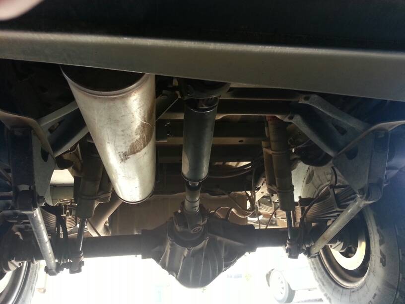

Re: Rear Traction Bar setups
Autofab 2 link for comparison.
- uploadfromtaptalk1398451967170.jpg (47 KiB) Viewed 2562 times
