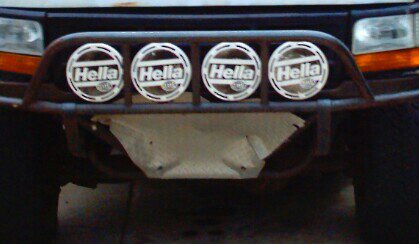

Re: How Thick is a REAL Skidplate???
Here was my first skid plate, made of 1/8 aluminum tread plate. This was one trip to Glamis when I stuffed the front end into a steep razorback. Aluminum Diamond plate is light but won't last very long. It will at least protect the bottom of the radiator. I went to an 1/8 steel plate and it has lasted for years.
