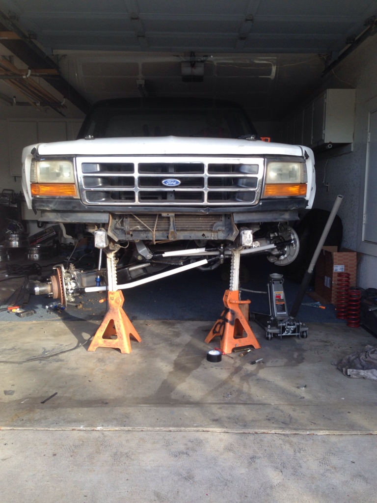

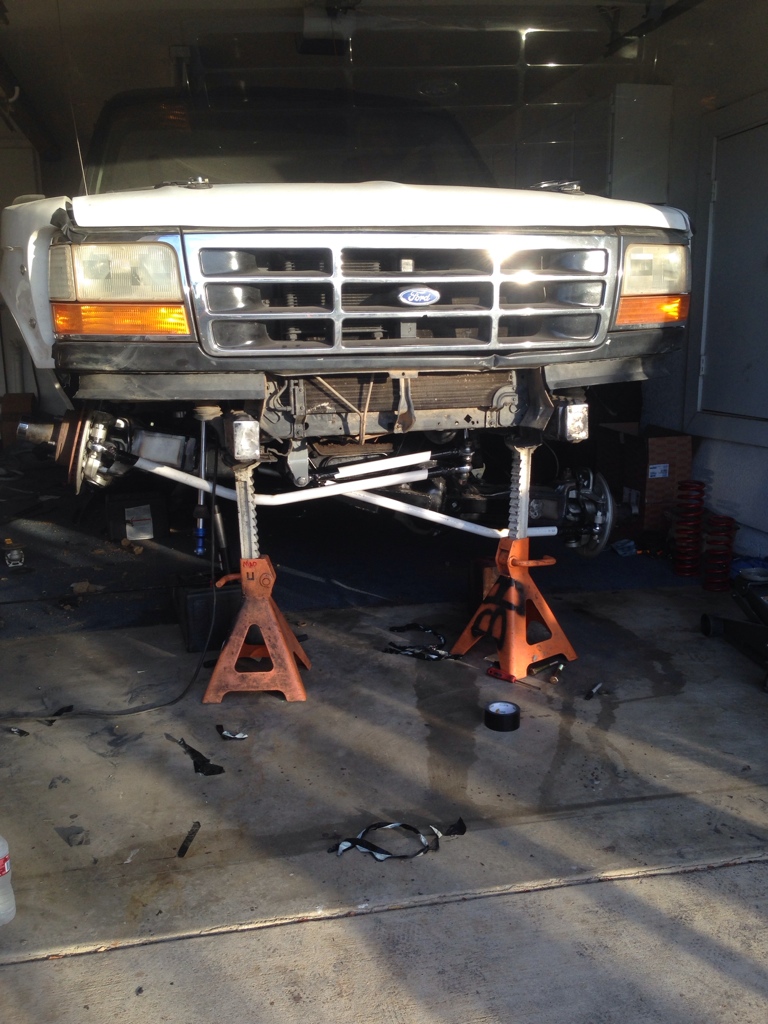

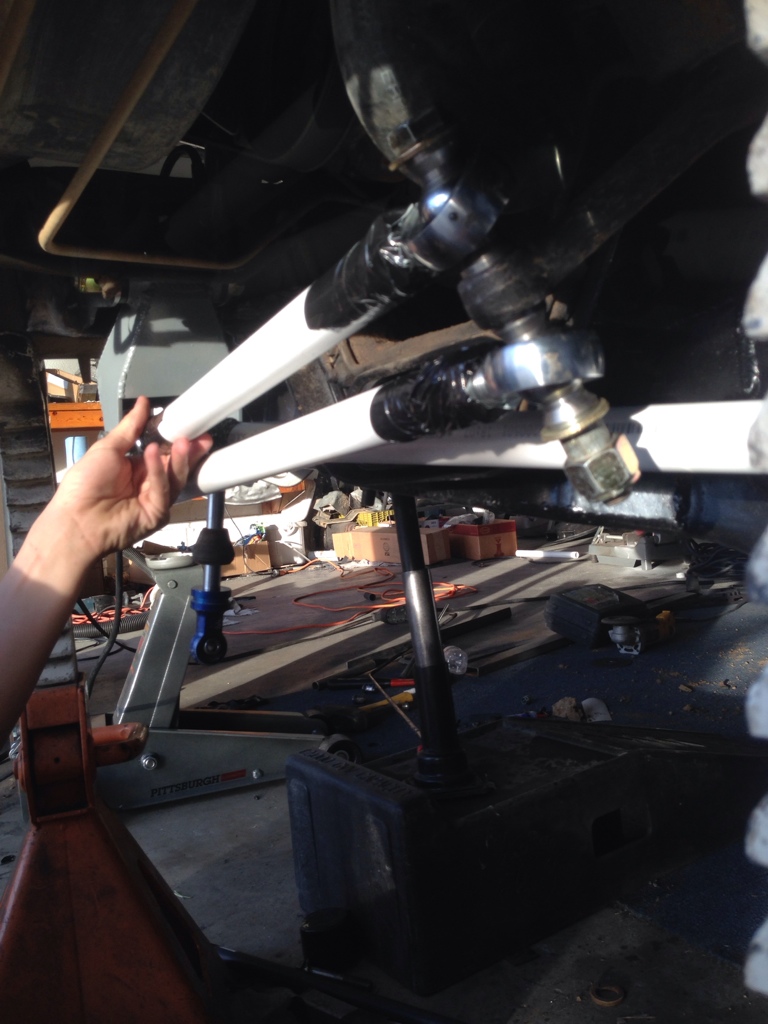

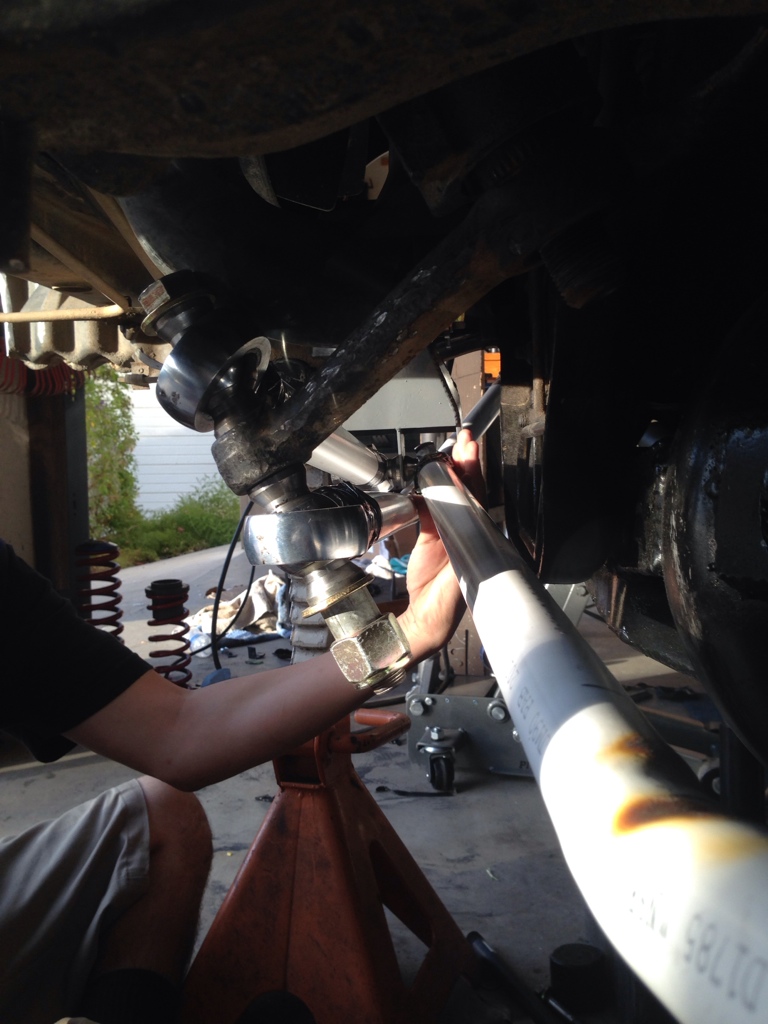

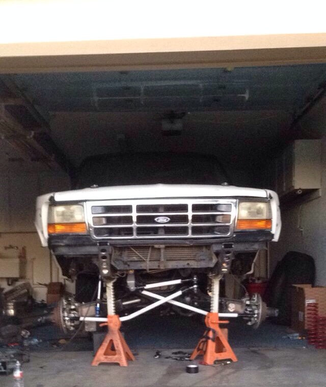

Alright so i want your input on this, do you see any issues?
Full droop
Tucked right
Tucked left
I had one binding issue but I fixed that and now I don't, but at full bump the closest my tierods come is a little less then 1cm, the PVC Was flexing and pulling so the steering looks as if it has some bump steer but when it sits in place the passanger has barley any, I'm using 7/8s hiem with 5/8s bolt, 3/4 on the single swing, and 1.25" .250 wall 4130 threaded, I feel like theres a lot of bend but I need it for clearencing, seem good? And yes I still need to double shear my pitman arm and re shear my spindles
Posts: 6026
Re: Steering Systems - Stock, Superunner & Equal Len. Crossover
Seems like clearances are ok, how about toe changes in the 4 positions ? ( both tuck, single tuck single droop , & both droop) if toe looks good in the. 4 positions I think you have something that will work.
