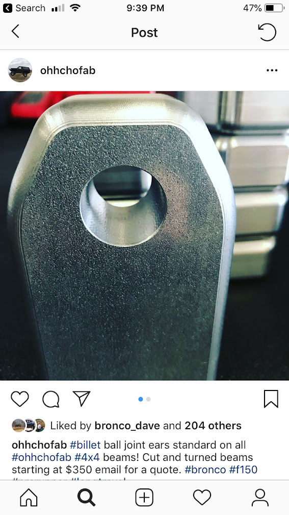

i am doing extend and c&t beams and would like a billet lower ear. threat gave me a price, i asked about shipping, then got an of stock response. the price was high and is a 'i dont want to sell it price'. cho had on his IG he would sell them, set i asked him about it , then he pulled the picture and hasnt responded to messages or emails. i understand the reluctance to sell them. id prefer not make them myself, does anyone know anyone who will sell them for a semi reasonable price?

It's a block with a hole in it. I think that anyone cutting and turning beams should be able to make it themselves. The reamer is under $100.

could i make one with the tools i have? sure but will it look nice like this? NO

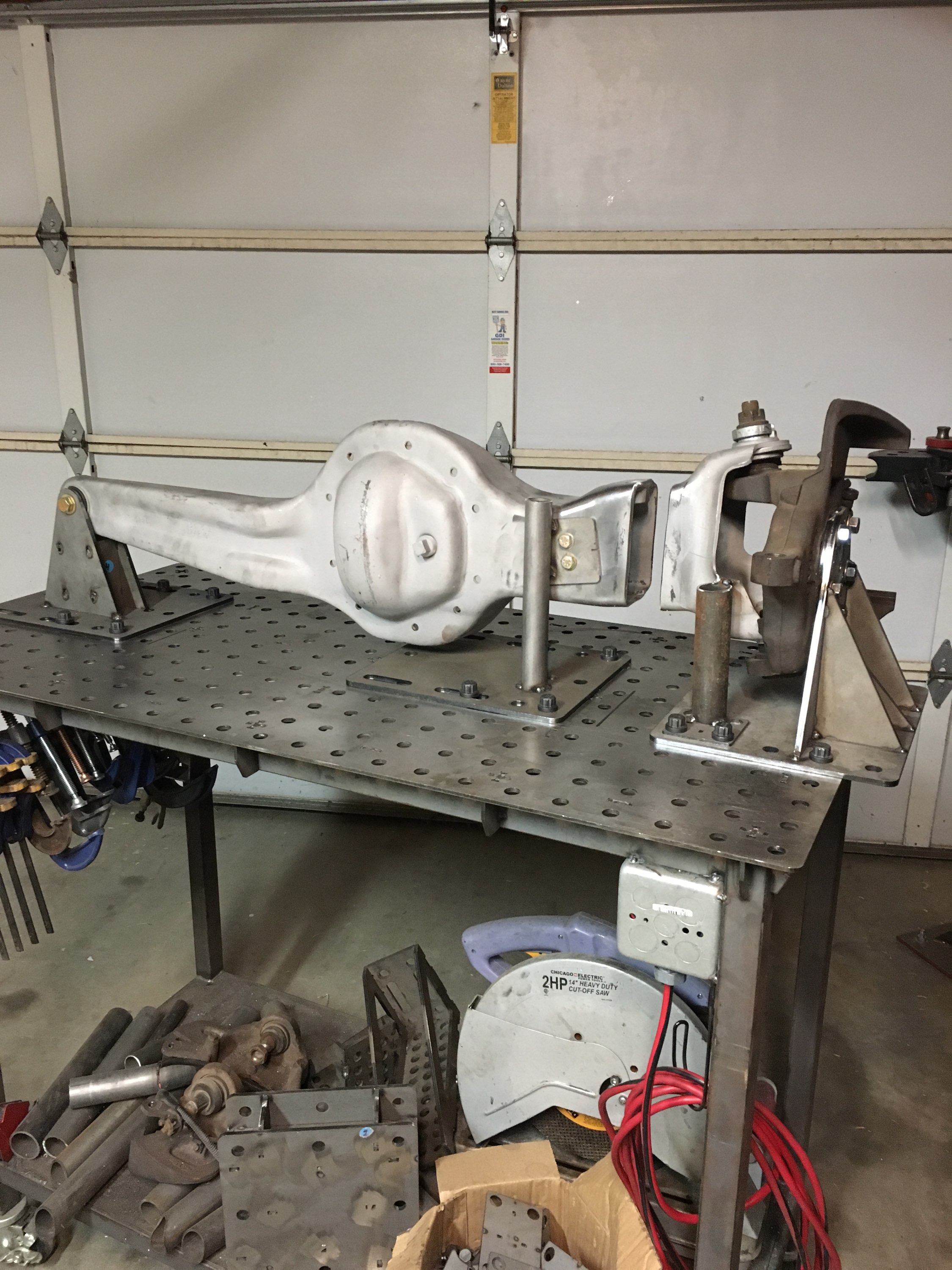

past life i was all about the hackfab, plenty of welds cooling on the way to the dezert. now i spend money and put things in place to force myself to do things better, which have resulted in a better quality on my work. the fixturing for my extension and C&T is over kill, but it forces me to keep the quality up.

holy huge picture, why cant i edit?

And I like the large picture. Makes it easier to drool on your fixture and table. Love me some weld/fab porn.

table was one of the best things i bought for my garage. wife parks her car in there, so everything has to be cleared enough to get it in there at the end of the day.

Very slick fixture btw- that’s as professional as any would find anywhere

Since you're doing this off of a jig why not place the beam so it dont have to cut the ear off at all? That's how my beams are it just takes more time to measure it up to be sure the axle goes right where it needs to in the hub
