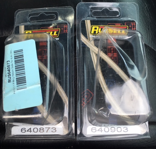

Hello All,
Just curious if anyone had the part numbers they used to connect -6an fittings to the factory fuel rails??

https://www.jegs.com/i/Russell/799/6408 ... vnEALw_wcB
Something like that? Don’t forget, the main line and return line are different sizes I believe.

And something like this for the pressure side:
https://www.jegs.com/i/Russell/799/640900/10002/-1

They are pricey little bastards. I’ll see if I can find the part numbers for when I did this a few years ago

I found these that I already bought and they work perfectly on a 95 F150 5.8 rail. I bought 1 of these off eBay and got it stupid cheap.
