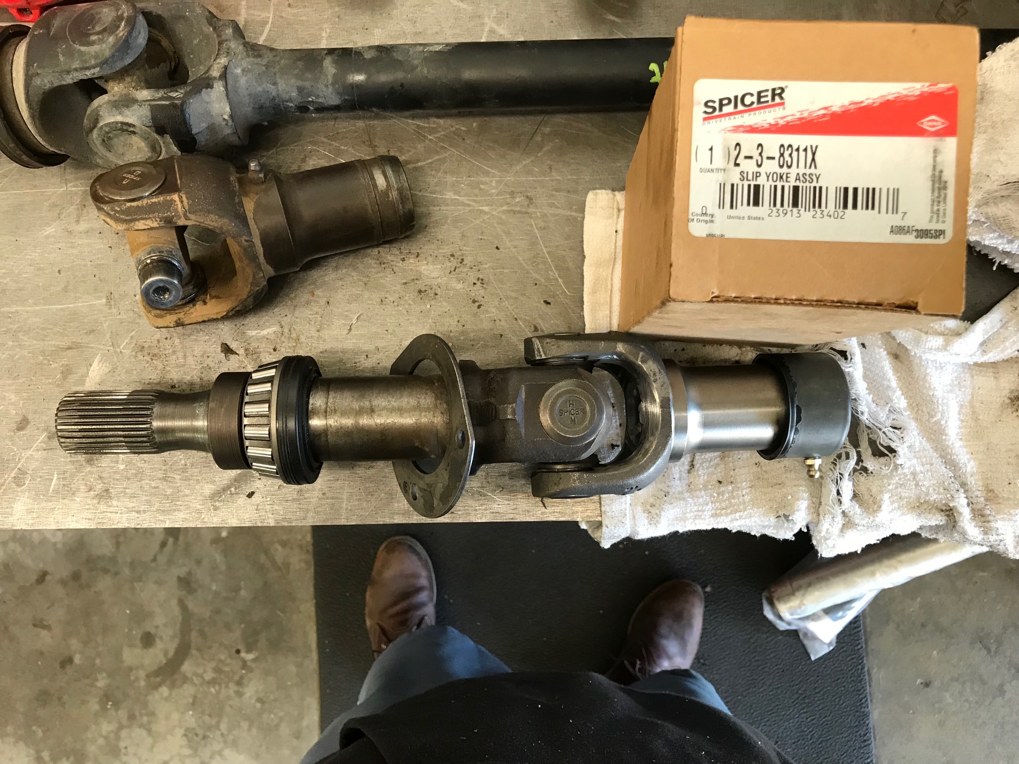

The earlier ones have a metal/rubber grease seal with a zerk fitting vs the later ones with just a rubber boot. Should be inter-changeable with the passenger inner axles. Are you running into an issue?
slip shaft difference 80-83 84-96
And I don’t believe 83 had the bolt in axle on the diff.
Just happened to have one on the bench that I just rebuilt.

I dug up the answer.
5.06" ON 84-96 SLIP
5.5" ON 80-83 SLIP

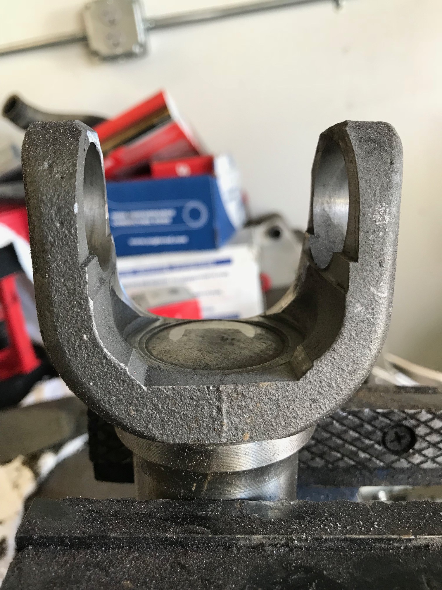

The issue is the slip is loose and I dont recall if I used the 80-83 slip or my 96 slip so I was trying to measure and see...now I know the difference! I probably have the 96 slip and engagement is lacking.

slip shaft swapped and tight as can be now, no more slop...so if you swap to a 3 bolt flange stub, swap the slip shaft too.
Had to reclearance it too...

So, the inner splines are longer on the 80-82 bolt in axle?
shockseals.com
Posts: 1116
Location: San Dimas
Re: slip shaft difference 80-83 84-96
Post by shockseals.com »
Slip shaft is longer and by the lack of slop, I will assume inner spline engagement is better(longer) since thats all I changed.
