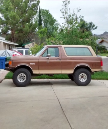

Anyone know what the wheel base is on a short bed F-150 and what the Bronco is??? Had a another thought on stretching the bronco with out stretching the Bronco??? How about you use an F150 Frame, do nothing to the body of the bronco, meaning you don't have to stretch the shell add F-150 sides? Move the rear tire opening around, also would have to trim interior wheel tubes, still have the tail gate and be able to mount the tires(s) on the rear...... Little photo chopping tonight I think....I shall return.

Okay not as cool as it was in my head... haahaaa Kind of Bronco on the brain I guess

Ewww
Wheel Base
The f150 frame is different in the rear I believe.

I'm sorry but that thing is ugly. 2wd and no removable top. The little side window looks like an after thought.
Re: Wheel Base
yup, the 80's ones are as ugly as the 70's - haha.
I think many people have had the idea of a stretch like this. Frames are definitely different (bronco is flat from about the rear shock mount back and stuck frame kicks up more).
