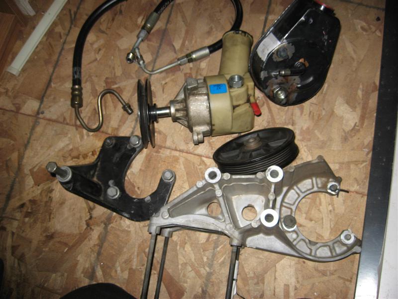

In the pic upper left is the 95E150 real Sag pump, bottom is the 96 bracket ac & lower pump. The Ford plastic pump above the bracket and an unsued pump bracket. Unknown application. High press hoses are from the 96. 2 pulleys the serp from the 96 was unused because it was a 1/2" like the vee belt one. I used the large shaft one off the e150sag for my install.
Next pic shjows the vendor pump like the previous post. It also is a sag but has the ford shaft and small res.
IMO find the cardon # for the teardrop res since it holds more fluid. Reply if you need the correct Cardone # and I will seach my records.

Study my post with the stuff laying on the floor to see both brackets and the large res canned ham pump. The other pic with the yellow cage tube has the vendor Sag/"U" bracket set up with a small res and the ford shaft. I do not have the Cardone # for that pump as it came with the Bronco. Philofab, does the 20-6244 have the Ford or GM shaft?
