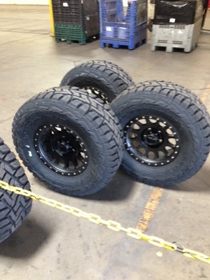

So I got trigger happy on the ol internet machine a few days ago and purchased a new set of wheels and tires. I picked up a set of the 17" Method NV's and 35" Toyo R/T's from 4wheelparts without really considering the 4.75" backspace on that particular wheel. After doing some research Im almost positive I'm going to have serious steering/rubbing issues with that set-up. Few questions:
1) Opinions on wheel spacers?
2) Should I just pick a new set of wheels? Although Im pretty sure the tires have been mounted so a simple exchange is probably out of the question.
3) Is anyone running the 17" NV's?

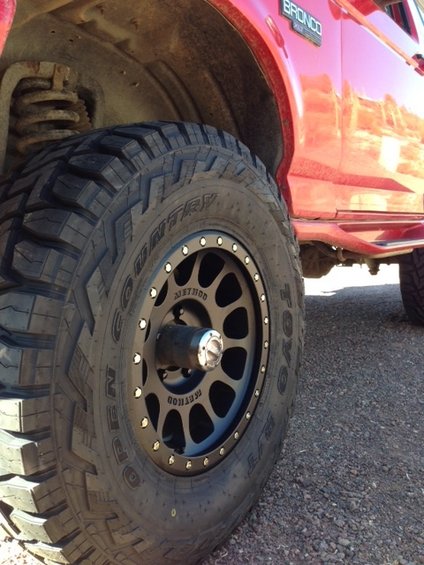

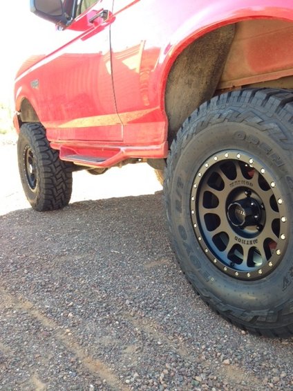

Threw two on to check clearance and they're all good. Lil rub at full lock so Ill probably install steering stops as Philo stated to keep em from rubbing. Synergy ball joints, coils, and shocks this weekend before I put em on. Thanks again for the help. Rad community here!
