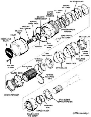

A few weeks ago I did the dirver side rotor on my 89. Last night I tackled the passenger side and noticed the 4 pin nut has a side with teeth that match up to another piece. I do not remember seeing that on the driver side. I will tear them both down tonight to compare. any one have any tips/suggestions.. maybe some diagrams

Stock auto hub print.
Re: front rotors/bearings
Pm me your email address if you want me to send the original so you can zoom without it getting blurry.
